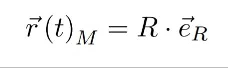

How would you set up the path-time function of a so-called Frisbee? For those who do not know what a Frisbee is, it is a kind of modified swing, the pendulum movement is still present, but at the same time the swing rotates around its own axis, thus executes a circular movement that should be assumed to be uniform.
View images, I'm new, so no idea how to post them here :(.

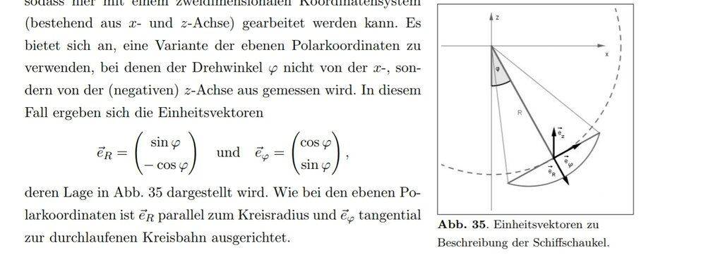

I would express the pendulum motion in form of polar coordinates with corresponding unit vectors in the x-z-plane (view images, ignore the german, sorry). How would you now bring in the circular movement, which is constantly changing its plane? Is it enough to simply add the representation of a circular path in the x-y plane to the equation underneath? That wouldn't take into account the constant "switching" planes, but rather assume that the circular disk is constantly parallel to the x-y plane, right? Unfortunately, I'm still a high school student, so I really don't know how to proceed from there. Many thanks for your help!

You have unit vectors ##e_R, e_{\phi}##. To express a position outside the XZ plane you need a unit vector orthogonal to those. How can you easily write an expression for such?
Having done that, you need a linear combination of that and ##e_{\phi}##, with the coefficients as functions of time.

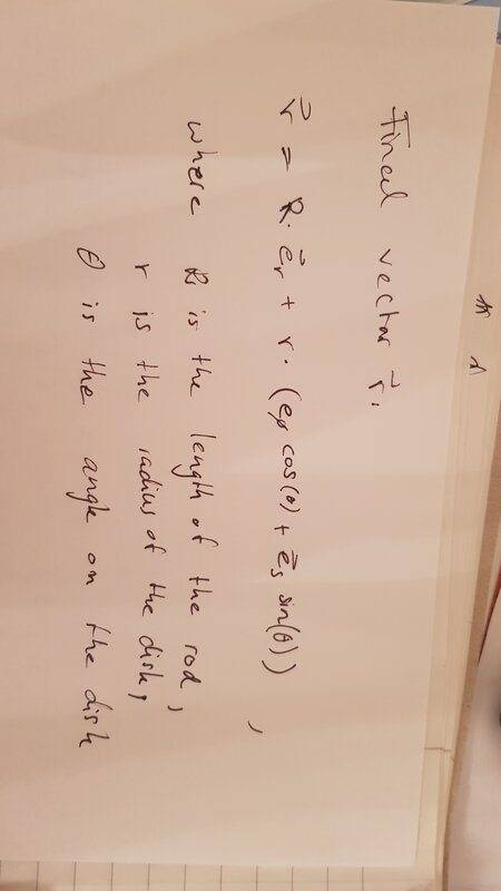

I hope to finally have reached the correct path/time function. I also calculated the cross product for the vector e_s, maybe you cam check but I'm pretty sure its correct. THANK YOU VERY MUCH TO EVERYONE WHO TRIED TO HEKP MY DUMB ASS. Btw are all of you students?
Kakainsu said:
I hope to finally have reached the correct path/time function. I also calculated the cross product for the vector e_s, maybe you cam check but I'm pretty sure its correct. THANK YOU VERY MUCH TO EVERYONE WHO TRIED TO HEKP MY DUMB ASS. Btw are all of you students?View attachment 267438
That all looks right, but you can take it further.
Assuming the pendulum is in SHM, you can write all the unit vectors as functions of time.
##\theta## can be replaced by ##\omega t##, making use of the info that the rotation is uniform.

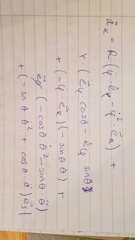

Now, if I were to differntiate the equation two times (which btw I don't know how to do, do you just differentiate r_1, r_2, and r_3 individually?), What kind of acceleration will i get or what meaning does it have, if I receive the value 15m/s^2? I do receive the values in m/s^2, right?
You cannot do that usefully until you have everything expressed in terms of time. You can do that following the steps I described in post #27.
