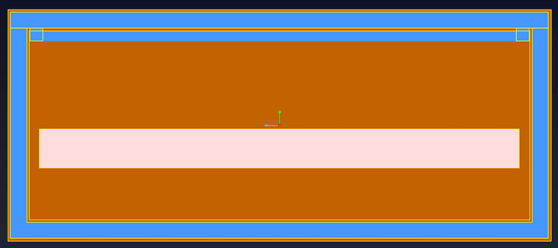

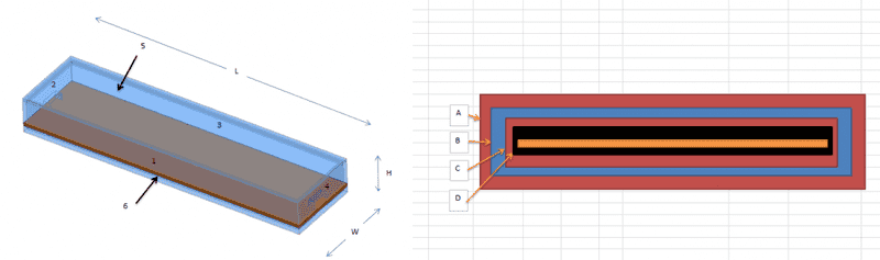

Hello, I will try and provide as much detail to the problem as I can with the hope someone can help me solve this. We are currently working on a wireless project that contains high electrical currents, because of this the box the electronics are enclosed in experience quite a temperature rise. The basic concept is I have a PCB that is housed inside a copper box, the copper box has 3 layers, outer layer is copper, middle layer is plastic, inner layer is copper. I want to calculate the temperature inside the copper box and outside the copper box.
Here are some details that we know:
The PCB dimensions are: 3mm H x 37mm W x 159mm L
The outer copper box outer dimensions are: 17.9mm H x 41.9mm W x 163.9mm L; wall thickness is 0.2 mm
The plastic box outer dimensions are: 17.5mm H x 41.5mm W x 163.5mm L; wall thickness is 3 mm
The inner copper box outer dimensions are: 15mm H x 39mm W x 161mm L; wall thickness is 0.2 mm
PCB Thermal conductivity: .25 W/m*K
Copper thermal conductivity: 400 W/m*K
Plastic thermal conductivity: .146 W/m*K
bPlastic emissivity: 0.9
Copper wall emissivity: 0.2
Ambient temperature: 20 C
max Temp: 41 C
Power: 7.6 W
Current: .48 amps
Resistance: 33 ohms
i have attached some pictures to help. Please let me know if you have any questions, I have been stuck on this problem.

Hire a mechanical engineer, if you are not one, or collaborate with and undergrad in ME.
Start your analysis with the source from then you can calculate all the rest. Study heat transfer dynamics.
Your target ΔT = 41-20 =21 centigrade

The material is ULTEM and the pcb is FR4.

Are all the materials arranged in compact not spaced void in between, when you cut it in a cross section? If so this is a conduction heat transfer. This may help
There is air space between the pcb and the inner copper box.

No, the pcb is set inside the copper enclosure. The heat is mainly caused by rf and stray currents.
It is not depresserized. It is a form of shielding. The reason I posted this is because my initial calcs are off by 80 degrees and I'm not sure what I'm missing. I am on the process of running an Ansys analysis but I was hoping to solve this by hand. We have tested this which is how I know the temperature reached 180 F
