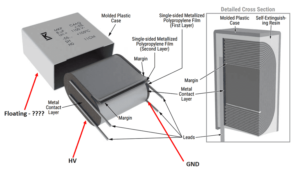

I'm still not sure about my original question though. I was wondering about the capacitor's clearance because of the capacitor's insulation. Of course the voltage rating is due to the dielectric making up the capacitance, but what about the plastic case which serves as insulation to outside components? If the voltage rating of the capacitor is 2 kV...I have that capacitor connected to GND and 2 kV. Then I have another series capacitor connected to 2 kV and 4 kV, why would you not also consider that the 4 kV capacitor is near GND when next to the 2 kV cap since there are GND planes within that capacitor. Therefore, it's actually seeing a maximum differential of 4 kV WRT external components. In other words, if I eliminate the potential issue of the terminals and tracking across the PCB, I would have to worry about the insulation between the capacitor shells at some point, right? Is that voltage so high that it's never considered?

If I place the terminals end to end, the terminals will be at the same potential. However, Cree claims that rotating them 180 degrees so the terminals are near each other gives the lowest inductance. I'm interested in understanding the implications of this on the capacitor insulation. We know the voltage of the terminals but we do not necessarily know the voltage of the floating case. If we assume the case is at the worst case, that puts the cases at 0 V and 4 kV in this example. The terminals are further in from the case so it may be possible to meet IPC-2221guidelines while still placing the capacitors right next to each other. So I'm wondering if designers typically consider the possible high voltage between the cases, or is it generally ignored. I haven't seen anyone discussing it so I'm leaning toward it is not considered.
I've attached the cap model that I'm looking at.

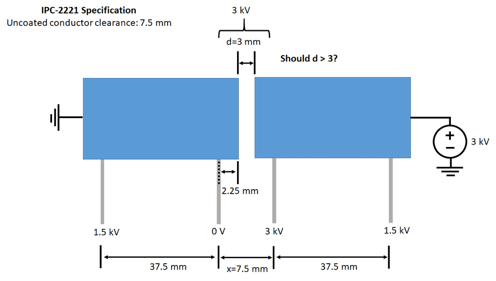

So, with regard to reliability - The capacitors you buy need to be able to withstand the HV stress they are rated for. Your concerns about insulation are well founded, but I think the worst case for internal insulation is the potential between the leads. I would use that spacing as you guideline. The component manufacturer would go out of business (so to speak) if they had breakdown in/over any part of their part when installed and maintained as intended. However, I would also avoid unnecessary external voltage stress to the part. Some manufacturers (not many) will specify the dielectric strength of the enclosure, you can look for that. You could also do some creative testing with a hi-pot or similar to see if you think the part is rugged in your configuration. It is also worth destroying one by taking it apart just to see how it's built.
I'm not 100% sure I understood your concerns about capacitor insulation, though. Ask a more specific question, if you like.
Finally, I'm sure you know this (and others have referred to it) but if not, review the difference between creepage and clearance for spacing requirements. The creepage numbers can get surprisingly big.

The component lead spacing is really large. For instance, one specific 1.5 kV capacitor (disregard the 2 kV discussion above) that I've considered has a lead spacing of 37.5 mm whereas IPC-2221 only specifies 7.5 mm. I've attached a better diagram of what I am considering. Dimensions, spacing, and voltages are labeled. In this layout, I think the cases should be considered to give the highest differential voltage for the system since they are floating and we do not know what they are.
I think I'll tear one apart and see what it looks like inside. I doubt that insulation will fail by placing them in close proximity for my application, but I haven't found this consideration discussed anywhere and depending on the design I think it might actually be damaging. I think it's an important consideration when deciding capacitor layout for optimal power density as their proximity could effect total board capacitance for a given area and mutual coupling. I wanted to see if not considering the case spacing would be a huge oversight on my part but it doesn't seem like it is at this point...for this layout anyway. Thanks for all of the input.
