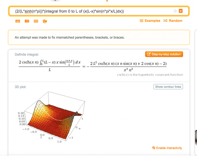

Based on this video:
near the end of the video they talk about the half range sine series.
Seems like b_n = (2/L) integral from 0 to L of f(x)*sin(n*pi*x/L)*dx
So if that is b_n, then we set it in the equation b_n = c_n*sinh(n*pi)
So c_n = b_n/sinh(n*pi)
Am I on the right track here?
I think I am on the right track. I got this when I plug my work in:
This looks very much like the form they have in the back of the book now.
The only difference is WHY did the back of the book change from a simple n to (2n-1) I understand that this is for n to be all odd numbers, but that doesn't make entire sense to me? Is it because all even n values produce a value of 0?
And then why do I get a 2 in front instead of an 8.
If you will simplify the expression ##(\pi n \sin(\pi n)+ 2\cos(n\pi) -2))## you might answer your own questions.
Likes RJLiberator
Ah, it is -4 for n=odd and 0 for n = even. I can see how this helps out.
Thank you for providing me help here. I am pretty damn close to really understanding the problem. I will put this at rest now.
