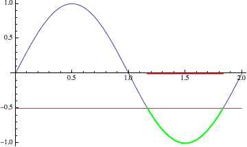

Try looking at a plot of x=cos(y) to deduce the PDF for X. If x=-1/2, for example, what portion of the graph would satisfy that? To what interval of y would this correspond to?

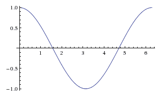

The function ##\cos(y)## is strictly decreasing on the y-interval ##[0,\pi]## and strictly increasing on ##[\pi,2\pi]##. Therefore, your statement that ##P(cos(Y) \leq x) = P(Y \leq \arccos(x))## may not be true. You need to think about this more carefully.

It is not the case that [itex]\cos(y) \leq x[/itex] if and only if [itex]0 \leq y \leq \arccos(x)[/itex]; in fact, since [itex]\cos(y)[/itex] is decreasing on [itex][0, \pi][/itex], if [itex]y \leq \arccos(x)[/itex] then [itex]\cos(y) \geq x[/itex].
Remember that [itex]\cos(y) = \cos(2\pi - y)[/itex] but [itex]0 \leq \arccos(x) \leq \pi[/itex] for all [itex]x \in [-1,1][/itex].

It's also clear that the CDF will be the same for both sin(Y) and cos(Y) since it does not depend on the phase, only on the range of Y. I have no idea how to calculate, for example, P(X ≤ 0.5). I feel like I'm missing something really obvious.
Take a look at this plot (which is of sine, not cosine, but it's the same idea). Does this help? The red portion of the domain corresponds to the green part of the graph. I plotted it in units of ##\pi## on the horizontal axis.

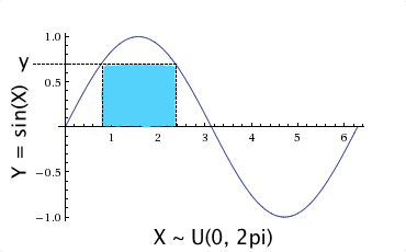

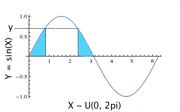

I'm not sure- I still feel like I'm missing something simple. Looking at the sin plot I can see a geometric solution as follows:
[tex]A_1=y(\pi-2\sin^{-1}y)[/tex]
[tex]
\begin{align}
A_2&=2\int^{\sin^{-1}y}_0 \sin x \,dx \\
&=2\left[ \cos 0 - \cos(\sin^{-1} y) \right] \\
&=2\left( 1 - \sqrt{1-y^2} \right)
\end{align}
[/tex]

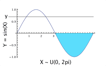

[tex]
A_3 = 2
[/tex]
Now I have that [itex]P(Y \le y) = \frac{A_1 + A_2 + A_3}{4}[/itex], but this doesn't seem to simplify to anything and I have the feeling there is a much simpler approach. I'm also not sure how to put it all together, considering that I have to rejigger everything if [itex]y \lt 0[/itex].
Take your three pictures together, one sine graph and the three blue regions shaded. Look at the x values where the blue touches the x axis. Call that set ##S##. You want the probability that ##x\in S##, which isn't that hard to calculate since ##X## is uniform. You really have only two cases to consider, when y is above the axis and below it. And the cosine problem is even easier because of the symmetry.
Remember that ##\arcsin(y)## is the x value just less than 1 in your picture. You can express everything in terms of that using symmetry.
