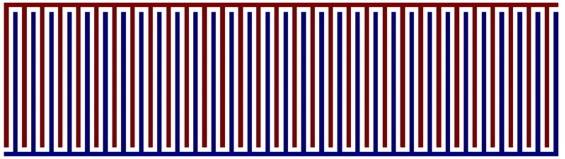

I just had an A4 sized PDLC film with a regular power supply and switch shipped to me for testing.
The two finger electrode sounds simple enough, however it depends if we can both find a off-the-shelf material to use for it otherwise manufacturing cost will be too high unless for large corporations.
Also, it depends on whether we can get the electrodes translucent enough to not beat the whole point of going with PDLC over LCD (that is, more than 50% unpolarized light transmittance).
I thnk ITO films can be etched without complex equipment. Just to be 100% sure, this is the arrangment of the electrodes we are talking about?
An ITO film can be etched to create such a grid with gaps between them. question is for shutter glasses whether we can get the gaps small enough to not be noticeable by the naked eye. A two sided ITO film would solve this problem easily by etching each side accordingly.
Any suggestions for the width of each finger?
Very close. All the Blue lines should be connected together and all the Red line should be connected together.
Two sided fingers would not be ideal, the electric field will be largely thru the substrate, whereas you need at least the fringing fields to be thru the PDLC.
This brings up the subject of finger spacing versus thickness of the PDLC. The larger the finger spacing the deeper the fringing field will extend into the PDLC. itself The tradeoff is a higher voltage between the fingers is needed. Sounds like a trial-and-error effort or much more research.

Whatever is the smallest practical without manufacturing defects. Since the ITO is transparent and will be very close to your eye and out of focus, the actual width isn't likely to be critical.
I just held a black pocket comb against the front surface of my glasses and could see through it. Being opaque, it was obviously present and annoying. Spacing was 16 teeth per inch, (0.0625in C-to-C) with a gap of 0.020in. With careful setup, you should be able to do quite a bit better. Hombrew circuit boards with 0.050 center spacing of conductors are doable... and it sounds like you have done this before. :wink:

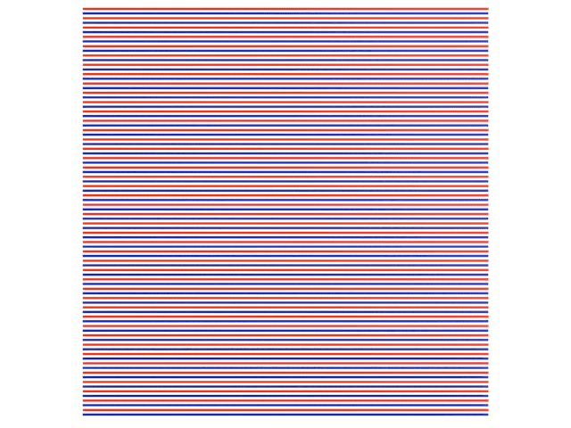

EDIT: Like this then?
kekkked said:
Any suggestions how to remove the original ITO pet film to be replaced with a custom etched one
Yeah, don't remove it, just etch the new pattern into the existing ITO. (That is if the ITO is on the outer surface.) If the ITO is on the inner surface, find a solvent for whatever adhesive is used. Try the common ones first like corn oil or rubbing alcohol, then go on to Vinegar or Ammonia. You may have to find the outfit that made the assembly and ask what the base of the PDLC film is, what the adhesive is or a safe solvent to use. Or you can dissolve the layer of PET. For instance Lye (Sodium Hydroxide, drain cleaner) will attack PET, eventually, so will Acetone; but Acetone attacks many plastics. They are all available over-the-counter but be sure of good ventilation and wear safety gear when using the stronger solvents.
kekkked said:
Like this then?
Yup.

By the way the lines are only connected on one side in the diagram, is that fine?
Yes. Your current is tiny so there is no problem with voltage drop.

I'm not concerned about voltage drop but rather whether this layout will generate the electric fields with the orientation and angle needed.
Well, it comes down to calculate it or try it. I understand there are some pretty good Field Solvers available but I've never used them. Perhaps others here can point out some useful ones.
