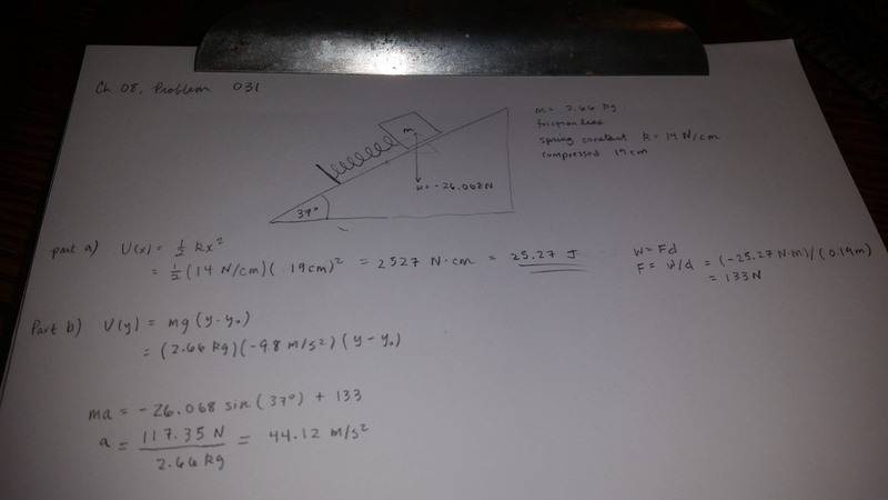

A block with mass m = 2.66 kg is placed against a spring on a frictionless incline with angle θ = 37.0° (see the figure). (The block is not attached to the spring.) The spring, with spring constant k = 14 N/cm, is compressed 19.1 cm and then released. (a) What is the elastic potential energy of the compressed spring? (b) What is the change in the gravitational potential energy of the block-Earth system as the block moves from the release point to its highest point on the incline? (c) How far along the incline is the highest point from the release point?
http://edugen.wileyplus.com/edugen/courses/crs7165/art/qb/qu/c08/fig08_43.gif
W=Fd, U(x)=1/2 kx2, U(y)=mg(Δy)
Im on part b, I am trying to solve U(y) but i don't have distance traveled in y direction. I think i need to find velocity next.
[/B]

In part a) it says 19.1cm, but in your working you rounded it to 19cm.
Your notes to the right of that show F=W/d. That only works for a constant force acting over distance d. If you want to know the compression force in the spring (but you don't need it for this question), use F=kx.
For part b), think about energy, and how you can use the result from part a).
for part c, I am getting a distance of .612m, which is the distance from the release point along the inclined plane of which the object traveled. Using the formula U(x) =mg(x-x0) and solving for (x-x0). where, U(x)=25.53J, m=2.66kg, g=-15.69N
J-dizzal said:
g=-15.69N
Why that value, and how come units of Newtons?

because its the component of weight that alone the axis of the plane.
Then you mean ##F=mg\sin(\theta)=-15.69N##. But how does that lead to .612m?
I thought it would make more sense to use it instead of -9.8m/s/s because the object is on an incline. I tried plugging in 9.8 but that still gives the wrong value. I tried using the kinematic displacement formula but time is not known. I have the objects initial velocity at release but I am not sure how to get distance from that.

i don't see why this wouldn't work;
W=Fd
d=W/F
d=(-25.53)/(-15.69)
d=400.6m​
By all means use ##g\sin(\theta)## instead of g, but don't write "g=" that value. g doesn't change. You compounded the error by incorporating the mass, turning it from an acceleration into a force. That's why I suggested you meant "F=". All very confusing.
J-dizzal said:
d=(-25.53)/(-15.69)
d=400.6m​
Your calculator appears to be broken.
