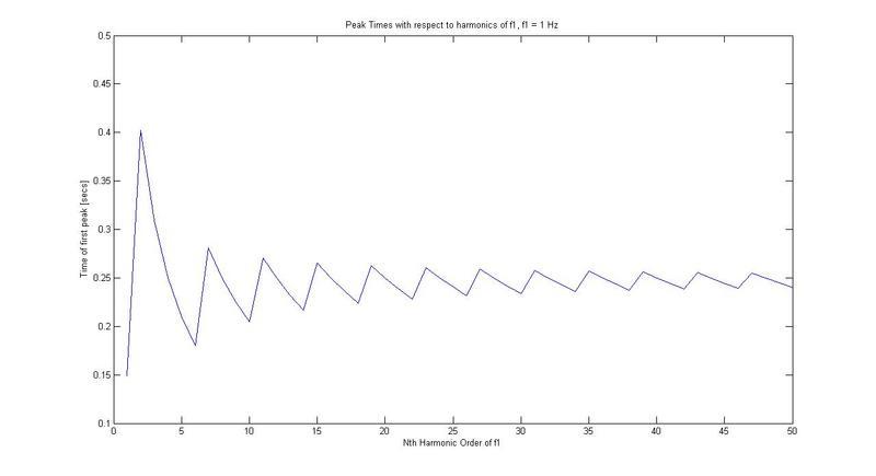

I'm trying to get a method to determine the time, t, when two sine waves added together peak, an exact solution. For instance,
F(t) = sin(w1*t) + sin(w2*t)
Obviously this is not really mathematically straightforward because there are infinitely many solution based on the nature of the sine function. But if w1 < w2, where w1 = 2*pi*f1 and w2 = 2*pi*f2, there is always at least one peak when 0 < t < (1/f1).
I'm not a mathematician but I have a fairly strong grasp of calculus. Of course the derivative gives you:
F'(t) = w1*cos(w1*t) + w2*cos(w2*t)
which doesn't help me a whole lot. So if anyone has a direction I can go, please give me a shout. Just to mention, I've tried using the Taylor series but it's not exact enough at low orders which is practical for solving. Thanks if you can help

I understand what you're saying. I'm at the point where a general solution isn't available (actually I kind of knew that when I posted this). But I'm not quite sure what you mean with t = Nq pi / w1. Actually more times than not, w1/w2 will be rational since pi generally cancels out then you have f1/f2 and if you work in hertz it will always be rational.
But that's not the issue. It's understanding how "far" the nth-peak of w2 (the peak closest to the first peak of w1) is from the peak of w1. This is easily calculated.
But because of the way the sine/cosine waves work around a circle, it's not going to be inbetween the 2 peaks in any apparent normal fashion.
In fact I uploaded a graph of the peak times versus harmonics of f1 (when f1 = 1 Hz). In this graph there is something peculiar though...whenever f2 = 4*n*f1 the time is always the same where n = 1,2,3,... In this case 0.25 secs.
Although it may seem like harmonics isn't the way to go, it's exactly what'll I'll be using this little project for, harmonic waveforms...regardless, that's where I'm at.
I'm thinking that this graph may be smoother if I consider more than just the "first peak", maybe the second and so on...It's to be determined...the research must GO ON!

Thanks for the response Phil, I did try this but the derivative still has 2 terms based on the chain rule which unfortunately, doesn't help unless I can constrict the function. I'm trying to use the taylor series dynamically to try and obtain an answer. If I set more restrictions on the f2, such as f2 = f1 + m where m is in Hz, I may be able to move a little further but I'm not sure yet. Thanks though
As PhilDSP suggested you have a maximum when (A+B)/2 = (4K+1)*pi/2 and (A-B)/2 = 2k*pi. Having this system of equations you can get t and k.
Cool, I'll check it out. Thanks I didn't realize what you were saying before Phil.
I think I may have come to the conclusion that a closed form solution isn't analytically possible based on the definition of a sine wave. I appreciate the suggestions. I may have to determine a solution through trial error and determine from there what to do. If anyone in the future can help with a closed-form general solution to the problem above, by all means let me know !
