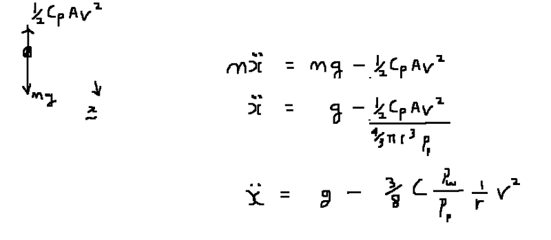

(a) Write down the differential equation governing pebble's descent. (done)

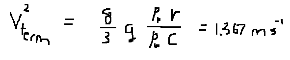

(b) Derive an expression for terminal velocity and evaluate it. (done)
(c) The pebble is dropped 5m above surface of lake, which is also 5m deep. Show that the pebble travels about 10cm in water before reaching it's terminal velocity.
Part (a)
Part (b)

1. Are you sure that C is the drag coefficient which uses the entire surface area of the pebble or just the cross-sectional area of the pebble?
2. You recognize that the acceleration of the pebble is x double dot. What about the velocity of the pebble? Can't the velocity also be represented in terms of x?

You need to substitute x double dot = dv/dt, and solve for the velocity vs time first. Also, what happened to the buoyant force?
The point about drag coefficients is that they are usually based on the cross sectional or frontal area of the body, not the total surface area.
The OP has used (4/3)pi*r^2, which is the total area of the pebble.

That's not how I read it. Seems to have written the mass as (4/3)pi*r^3*density, then canceled one r and π with the expression for cross-sectional area. Not that there was much point in doing that: the mass is given, the density is not.

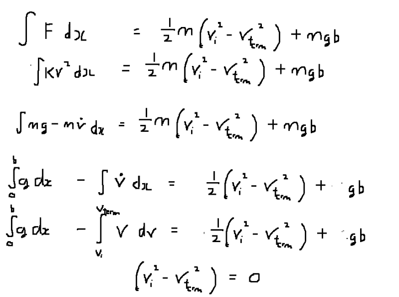

I'm more concerned about the integration part; to find the work done against resistance. Is there anything wrong with that?
When you lost k from your equations, you might have realized you were off course. K must feature in the answer. There are errors further along, but they're not relevant to finding a correct solution.
i don't think you can hope to integrate v2dx straight off. Work with the forces and get the differential equation for the acceleration.

Substitute v2 using the differential equation and integrate; which was what I did but I'm not sure what's wrong with my working...

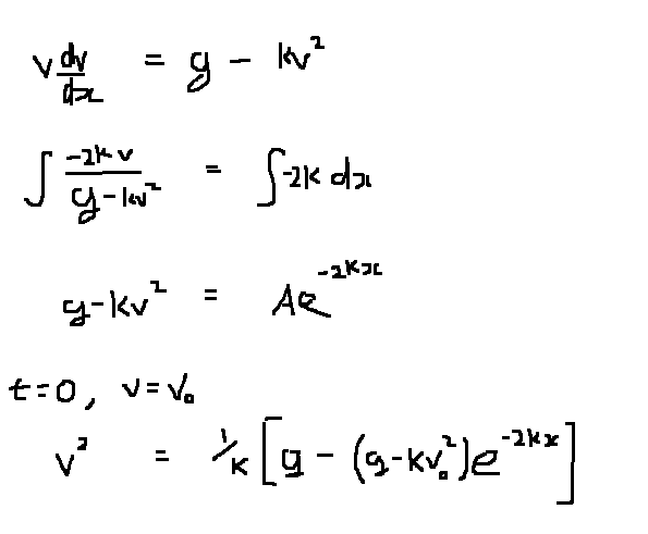

a) Solve the differential equation to obtain v in terms of x. show that when x = 0.1 m, v = vterm

As I said, that substitution lost k, and as soon as that happened you were going nowhere. At best you'd end up with tautology. As it happens, you must have made some other error, but I don't think it's interesting to figure out what.
You have [itex]\ddot{x}=\dot{v}=g-kv^2[/itex]. You could solve that to find v in terms of t, but there is a trick to eliminate t first and solve for v in terms of x. Is that what you mean?
yeah. replace dv/dt by v(dv/dx) then solve the diferential equation, putting initial condition as v = √2gh.
then substitute v = vterm to find that x = 0.1 m...

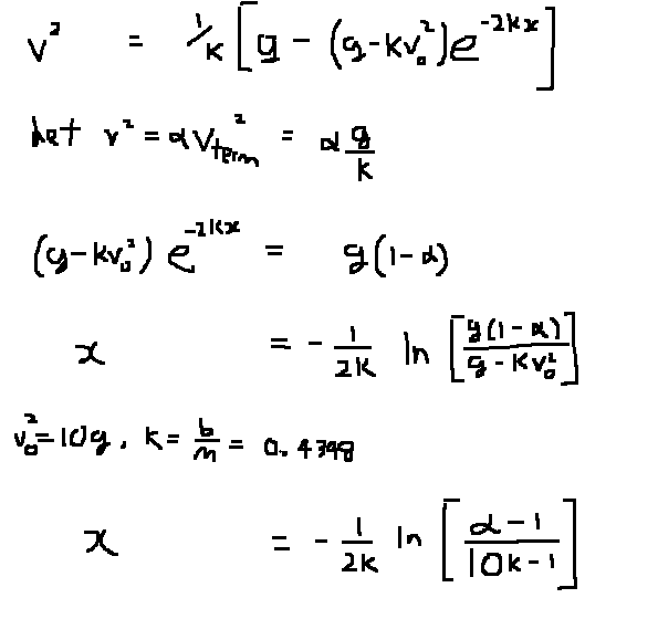

I did some working here using method 2, to express v in terms of distance traveled x:
k = b/m = 0.4398 and 1 < α ≤ 10k
Next, i let α = 1.1 ≈ 4% above vterm
I get x = 4m = 40cm...
There's something screwy in your second line, but after that it looks right.
It's a bit hard to guess what they consider to be effectively terminal velocity. How about Plugging in x=0.1 and see what you get for alpha?

I got a crazy a = 4.. which is slightly below the maximum a = 10k = 4.398
Are you considering that the first five meters are in the air above the lake?
I get slightly different numbers... 2k = Cρw A / ρp = 3 Cρw / (ρp 4r) = 3*0.7*1000/(2500*0.02) , k = 5.25. (With buoyancy, k = 8.75.)
(v/vt)2-1 = ((v0/vt)2-1)e-2kx = (10k-1)e-2kx
So with x =.1, (v/vt)2-1 = 51.5e-1.05 = 18. As you say, much too large. With buoyancy, 15, hardly better (about twice terminal velocity.).
