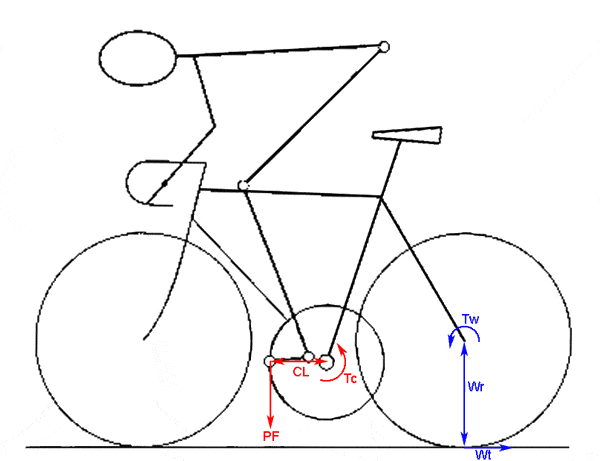

I heard that bike-racers can put put 1500 watts in sprints. Using this site: http://www.noping.net/english and entering the following:
- Racing bike - hands on the drops
- weight = 170 lbs
- power = 1500 watts
Then hit CALCULATE button and I get a speed of 43.2mph. I came up with this diagram to figure out all the forces and torques in order to come up with pedal-force:
0.336m = Wr = Wheel Radius
0.170m = CL = Crank length
Given 52x13t gear ratio of 4:1, Tc = 4*Tw; torque at crank is 4x higher than torque at wheels.
Then using this site: http://www.analyticcycling.com/GearCadenceSpeed_Page.html, I enter:
speed = 43.2mph
chainring = 53t
cog = 13t
wheel-diameter = 0.672m
Click on RUN MODEL and I get 135 rpms at the crank.
What stops me next is how to figure out what PF - pedal force is in order to generate 1500w and go 43.2mph @ 135rpms. ?
Thanks.
The fastest way would be to identified your foot' speed.
v = 135 rpm * (pi/30 rad/s/rpm) * 0.170 m
v = 2.4 m/s
Then the force is:
F = P/v = 1500 W / 2.4 m/s
F = 624 N (= 140 lb)
Longer way:
The tire friction force is:
Ft = 1500 W / (43.2 mph * 0.44704 m/s/mph)
Ft = 77.67 N
The torque at the wheel:
Tw = 77.67 N * 0.336 m
Tw = 26.1 N.m
The torque at the pedal:
Tp = 26.1 N.m * 53/13
Tp = 106.4 N.m
Force at the pedal:
F = 106.4 N.m / 0.170 m
F = 625.9 N
The difference only lies in the rounding-off error (the actual crank rpm is 134.6 rpm).
This is a little high, as it should be.
If you burn 1500J/s, that doesn't mean you are doing 1500W of work on the pedals. A lot of this energy is being lost elsewhere.
Thanks Jack, the 1st way really was simple. :)
It may appear pedal-force is high, top-sprinters can exert quite a bit of force on their pedals. Due to the alternating motion, it's only coming mostly from one leg at a time. And we're calculating perfectly symmetric motion, but I suspect the up-stroke has minimal power. So the downstroke would have to be even higher than the numbers we're coming up with.
