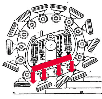

What is the physical explanation behind the pedrail wheel (a.k.a the walking wheel). Someone said it "makes it's own road", but how does it allow a vehicle to climb stairs, navigate rough terrain etc.? I have looked all over the Internet and even visited a university library, but information on this system is limited. I am trying to learn the operative principle(s) underlying this mechanism.

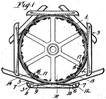

The device is simpler than it may look. Between the video anorlunda provided and the wiki age diagram, you can derive the operating principles. It's akin to a tank tread, but as short as possible.

Thank you! Is the wheel simply riding over the feet?

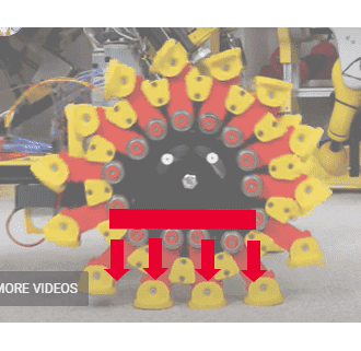

Not quite. The hub (which is attached to the axle) has a flat bottom that forces the bottom four or so feet into a flat, surface-hugging shape - much like the tread of a tank does.
I just realized - it is functionally equivalent to simply riding on flat tires! (And that is possibly the secret to making this a practical invention.)

The Dreadnaught wheel will give a smoother ride, and could be adapted to fit onto a tyre if there was sufficient clearance, or smaller wheels were used.
