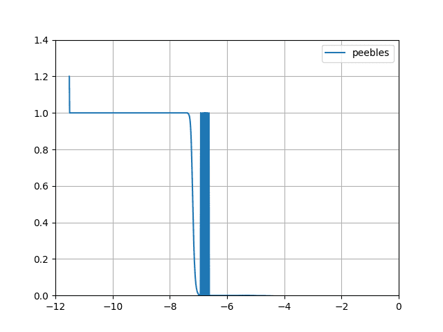

The graph I get is this
Can someone point out my mistake please? Or should I be using some other solver?
I have used both Runge Kutta 4th order and Radau IIA 5th order.
My initial conditions are:
a (scale factor) start (ts) = log(1e-5)
a end (tn) = log(1)
dt = (tn-ts)/1000
Xe = [1.2]

I'm plotting scale factor 1e-5 to 1 as x-axis in log form and the Xe as y-axis; Xe[start] = 1.2
Your new fragment doesn't call your fu function.
Unless you give us the complete program it's going to be almost impossible to help you with it. It's like going into a garage carrying an engine block and asking why your car doesn't run - at the moment it doesn't run because it isn't a car, it's just part of one.

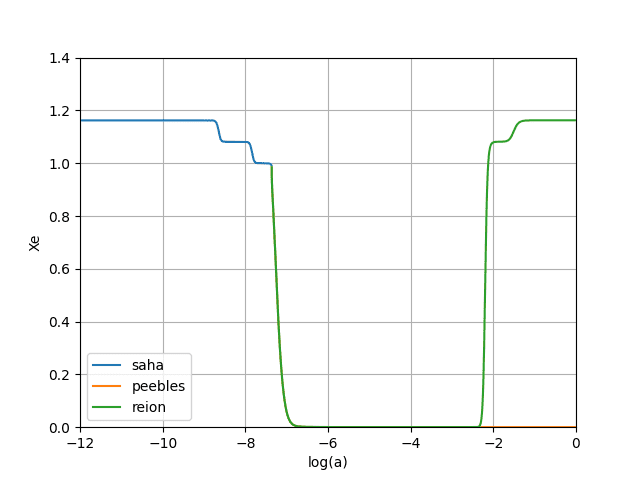

I have solved it. Is anyone interested or should I just close this thread?
Vick said:

The constants and imports are the same. However, I have modified the function itself for better debug and so I split it in several different ones.
I have also added the Saha Equation as shown in the article quoted above and also included reionization.
The necessary functions for Saha, Peebles and Reionization are as follows:
Saha, Peebles & Reionization:
def sah(a):
    Tb = kb*cmbt/a
    np = (mpf('3')*h3**2*bdp)/ (mpf('8')*pi*g*mH*a**3)
    factor = ((mel*Tb)/(mpf('2')*pi*hp1**2))**(mpf('1.5'))/np
    fe  = mpf('1.0')
    fe_old = mpf('0.0')
    while (abs(fe-fe_old) > mpf('1.0e-10')):
        fac1 = 2.0*factor*exp(-xhi0/Tb)/fe
        fac2 = 4.0*factor*exp(-xhi1/Tb)/fe
        facH = factor*exp(-Ry/Tb)/fe
        x1 = fac1/(1.0 + fac1 + fac1*fac2)
        x2 = fac2 * x1
        xH = facH/(1.0 + facH)
        fe_old = fe
        fe = (2.0*x2+x1)*Yp/mpf('4.0') + (1.0-Yp)*xH
    Xe = fe/(1.0-Yp);
    ne = fe*np
    if (Xe < saha_limit):
        return 0, 0
    else:
        return Xe, ne
 def reion(a, Xe):
    fHe = Yp/(mpf('4')*(mpf('1')-Yp))
    yreion = (mpf('1') + zreion)**mpf('1.5')
    y = exp(-mpf('3')*a/mpf('2'))
    delyreion = mpf('1.5')*sqrt(mpf('1')+zreion)*delzreion
    rr = Xe[0] + (mpf('1')+fHe)/mpf('2')*(mpf('1')+tanh((yreion - y)/delyreion))+fHe/mpf('2')*(mpf('1')+tanh((zhereion-(exp(-a)-mpf('1')))/delzhereion))
    return rrdef H(a):
    return h3 * sqrt( (r * a ** mpf('-4'))
                      + (m * a ** mpf('-3'))
                      + (k * a ** mpf('-2'))
                      + l * exp(mpf('-6') * w1 * (mpf('1') - mpf('1')/ a)) / (a ** -(mpf('3') + mpf('3') * w0 + mpf('6') * w1)))def Tb(a):
    return kb*cmbt/adef nb(a):
    return (mpf('3')*h3**2*bdp)/ (mpf('8')*pi*g*mH*a**3)def o2Tb(a):
    return mpf('0.448')*ln(Ry/Tb(a))def a2Tb(a):
    return mpf('8')/sqrt(mpf('3')*pi) * sigmaT * sqrt(Ry/Tb(a))*o2Tb(a)def BTb(a):
    return a2Tb(a)*c*((mel*Tb(a))/(mpf('2')*pi*hp1**2))**(mpf('1.5')) * exp(-Ry/Tb(a))def delta(a, Xe):
    return ((mpf('1')-Xe[0])*BTb(a)/(c*nb(a)*a2Tb(a)*Xe[0]**2))def B2Tb(a):
    return BTb(a) * exp(mpf('0.75')*Ry/Tb(a))def n1s(a, Xe):
    return (mpf('1') - Xe[0])* (mpf('1')-Yp) * nb(a)def La(a, Xe):
    return H(a) * ((mpf('3')*Ry)**3)/((mpf('8')*pi)**2 * c**3 * hp1**3* n1s(a, Xe))def CrTb(a, Xe):
    L2s1s = mpf('8.227')
    return (L2s1s + La(a, Xe))/(L2s1s + La(a, Xe) + B2Tb(a))def fu(a, Xe):
    if delta(a, Xe) > mpf('1e-20'):
        return [CrTb(a, Xe)/H(a) *(BTb(a)*(1-Xe[0])-c*nb(a)*(mpf('1')-Yp)*a2Tb(a)*Xe[0]**2)]
    else:
        return [mpf('-1')/H(a)*c*nb(a)*(mpf('1')-Yp)*a2Tb(a)*Xe[0]**2]
I still used Runge Kutta 4th Order, albeit with a smaller delta t as shown below:
initial conditions and time step:
ts = mpf('-12')
tn = mpf('0')
st = (tn-ts)/mpf('100000')t1=[]; t2=[]
a1=[]; b1=[]; nel=[]; ree=[]; nee=[]
t3=[]; t4=[]for i in arange(ts, tn+st, st):
    x = sah(exp(i))
    if x[0] > saha_limit:
        t1.append(i)
        t3.append(exp(i))
        a1.append(x[0])
        nel.append(x[1])
    else:
        breakxx = [ a1[-1] ]
for i in arange(t1[-1], tn, st):
    t2.append(i+st)
    t4.append(exp(i+st))
    xx = rungk4(fu, exp(i), xx, st)
    b1.append(xx)
    x2s = reion(i, xx)
    ree.append(x2s)
    nee.append(x2s*(mpf('1')-Yp)*nb(exp(i+st)))
The first loop is for Saha and the second for Peebles and Reionization.
Please note that my code includes Helium as well, as per requirements of the article.
The final graph is as it should have been.
