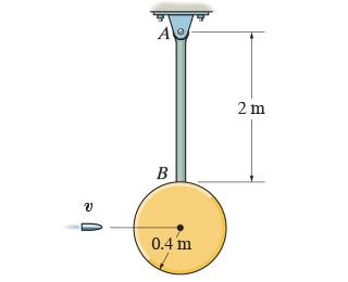

This took a lot of time and effort and I understand if you wish to skip past everything and just read my questions about it in the The too long didn't read summary (TL;DR) at the bottom.
The 10-g bullet having a velocity of v = 750 m/s is fired into the edge of the 6-kg disk as shown. The disk is originally at rest. The rod AB has a mass of 3 kg.
Determine the magnitude of the angular velocity of the disk just after the bullet becomes embedded into its edge.
Calculate the angle θ the disk will swing when it stops.
Express your answers using three significant figures.

Knowns:
vb = 750⋅m⋅s-1 (velocity of the bullet)
mb = 0.01⋅kg (mass of the bullet)
md = 6⋅kg (mass of the disk)
mr = 3⋅kg (mass of the rod)
Lr = 2⋅m (length of the rod)
rd = 0.4⋅m (radius of the disk)
Unknowns:
ω = ? [rad s-1] (Angular velocity of the system just after the bullet embeds in the disk) [radians per second, 3 significant figures]
θ = ? [°] (Change in the angle the pendulum makes from rest to its highest position before coming back after collision) [In degrees, 3 significant figures]

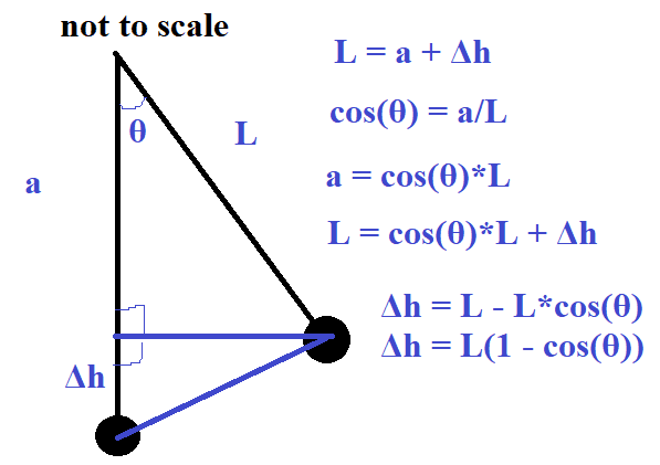

Since we are interested in the angle θ and not Δh, Δh must be rewritten in terms of Lr, rd and θ
L being the distance from the center of mass of the part of the system to the axis o located at point a.
Applying Δh = L(1 - cos(θ)) to our energy balance equation
(1/2)Isys⋅ω2 = [md(Lr+rd) + mr(1/2)Lr]g(1-cos(θ))
θ = arccos(1 - [(1/2)Isys⋅ω2]/[md(Lr+rd) + mr(1/2)Lr]g])
θ = arccos(1 - [(1/2)(IA + mb(Lr + rd)22]/[md(Lr+rd) + mr(1/2)Lr]g])
θ = arccos(1 - [(1/2)((39.04⋅kg⋅m2) + (0.01⋅kg)(2⋅m + 0.4⋅m)2)((0.460386315 rad s-1)2]/[(6⋅kg)(2⋅m + 0.4⋅m) + (3⋅kg)(1/2)(2⋅m)](9.81⋅m⋅s-2)])
θ ≈ 12.650008408°
θ ≅ 12.7°
