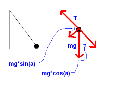

I've had trouble with free force diagrams for pendulums, and I can draw one out but I can't find the force component in the X direction. If T = tension in the string, then the component in the X direction should be sin(theta)*T. T should equal m*g*cos(theta), so shouldn't the total force in the X direction be sin(theta)*cos(theta)*m*g

I understand now that I was wrong, and I know what a free body diagram looks like. But I don't understand why.
With a = theta:
In my diagram, vector addition of mg*cos(a) and mg*sin(a) would equal mg and mg*cos(a) would equal T. Is this diagram only for a swinging pendulum without any external force?
What is the reasoning for the diagram with the external electrical force? Why does the first diagram not work?
Your diagram is still pending, but it sounds like you chose axes that line up with tension because weight is split up into components. Youre making much more work for yourself because the weight and electric forces are perpendicular. If you choose axes along these forces, tension is the only thing split up into components.
This problem can be solved just like a simple statics problem in which a mass is held by one horizontal and one angled string. Weight cancels the vertical component of tension and electric force cancels the horizontal component of tension. Then just divide by the field to get the charge
Your second diagram looks correct, except for one thing: you haven't shown the electric force on the charge. For the charge to be in equilibrium,
[tex]\vec{T} + \vec{W} + \vec{F_{elec}} = 0[/tex]
You have resolved the weight correctly. The electric force on the charge is very much a "real" force that needs to be considered while computing the net force on the charge (as you already know).
As for the freebody diagram, it is helpful to indicate the angle [itex]\theta[/itex] between the weight vector and the direction along the rope, until you are sufficiently proficient to resolve forces by inspection.
You see, there are three forces on the charge (particle) which must be such that their vector sum cancels (for equilibrium).
In the present system,
[tex]T\cos\theta = mg[/tex]
[tex]T\sin\theta = F_{elec} = qE[/tex]
Eliminate the tension force T between these two equations and that gives you your answer.
Hope that helps.
