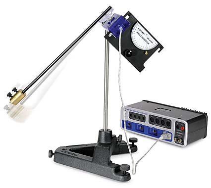

Do you have a picture of the setup? How did your ridiculously huge mass look like and what was its shape?
It's weird because the greater the length of the pendulum, the more accurate the g value became. For the 30cm pendulum it was 9.7ms^2 whereas for the 5cm one it was 3.24m/s^2 which is just ridiculous. Is it possible for the accuracy to increase with increasing lengths? I looked at other experiments and sample sizes tended to begin at 30cm.
Sure, I've attached a picture -it's similar to that one except we only used one of the masses (one golden mass whereas in the picture they used two).

Your picture leads to so many questions...
- was the pendulum tilted as shown in the picture?
- did you take the mass of the rod into account?
- did you just shift the golden mass along the rod, did you shift the rod, or how did you change the length?
If you just shifted the mass along the rod I can perfectly see why you got nearly the same period for 5 and 10 cm. The pendulum was mainly the rod then, with just a small effect from the golden mass. In that case there is hope to get the values in agreement with expectations.

No the pendulum wasn't tilted, it was just straight and was instead attached to a retort stand. I didn't realize that the mass of the pendulum would affect its period -what formula would that relate to? Yes, we did shift the golden mass along the rod and the length of our pendulum was essentially from the position that the rod is attached to the retort stand to the top of the golden mass.
Why do you expect the golden mass to play a role but the rod to be irrelevant?

Does the black box also swing up and down as the pendulum swings back and forth? If so, the black box acts a second pendulum attached at right angles to the first one, and unless it (the box) is feather-light, its mass and motion must be taken into account. So, it looks like you have a two-armed pendulum, with one end fixed and the other (longer) end at variable length.

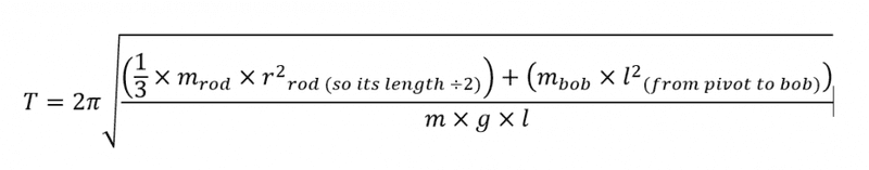

So far, this is the formula that I am using: (i've attached it). Is it correct?

Instead of l, you'll have to find the center of mass of your system.
The 5 cm above the pivot will contribute to the moment of inertia as well.

But if I was investigating the effect of length of the pendulum on its period, where would I include these lengths? Or is it related to the center of mass?
I'm so sorry, I'm pretty hopeless at this, it's far beyond the scope of our curriculum (but it's a design investigation).
The distance to the center of mass is some equivalent to the length.

Yes, it does seem to be beyond what you expect.
I will lay out the (almost) full formula based on the information you have provided. Let:
L = total length of rod
D = distance from top of rod to pivot
m = mass of rod
M = mass of cylindrical bob
R = radius of bob
H = length of bob
X = distance from pivot to centre of bob
I will ignore the radius of the rod.
Moment of inertia of bob about a horizontal axis through its centre = (M/4)(R2+H2/3)
m = mass of rod
R = radius of bob
H = length of bob
To get its MOI about the axis, add MX2. (Parallel axis theorem.)
Moment of inertia of the rod about its centre = mL2/12
To get its MOI about the pivot, add m(L/2-D)2
Add the two MOIs about the pivot to get the total MOI. Call this I.
The restoring torque is τ=g sin(θ) (Mx+m(L/2-D)).
The period will be 2π√(I/τ)

  • #31
Shyanne said:
is that for a cylindrical bob?
Yes.
It's unusual for me/us to supply such a complete solution, but I feel it is appropriate in this case. However, I'd like to believe you understand how these formulae come to be . Please ask me to explain any parts you don't get.
  • #32
haruspex said:
Yes.
I think I understand all the components, however I do have one last question (sorry): I understand that the torque is τ=mghsin(θ) but I do not understand why we are multiplying the masses by both X and (L/2)-D instead of only X.
  • #33
The two mass centres are different distances from the pivot. The bob is at distance X, the rod's centre is at L/2 from the end above the pivot, so at distance L/2-D from the pivot.
(I have assumed the rod stays fixed and the bob slides on the rod.)
  • #34
With the approach of post #29 and values from the thread, I get values between 9.86 and 10.33 m/s^2. That looks reasonable.
If the bob length is reduced to 3 cm, the values fit even better with a range from 9.82 to 9.99.
