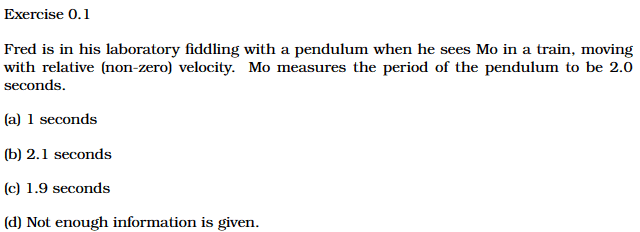

The problem and solution are,
However, I don't understand why the answer is correct. I think that time should be dilated since ##\Delta t = γ \Delta t_0 = 2γ## where ##γ \geq 1## for ##v \geq 0##.
Does anybody please know what I'm doing wrong here?
Thanks!
Is this the entire question? It seems to be missing some parts. Like, are they asking what Fred measures the period of the pendulum to be?
Thank you for your reply @Drakkith!
Yes sorry, that is a typo of mine. It should also read: Which of the following is a possible measurement that Fred could make for the period of the pendulum?
Thanks!
Likes Drakkith
Notice that Mo measured Fred's pendulum as having a 2.0 second period. That is, the pendulum is in the lab frame, not the train's frame. So that's the measured value with time dilation. What should the period be in Fred's frame? Shorter or longer than 2.0 seconds?
  • Love
Likes member 731016
Thank you for your reply @Drakkith ! I think understand now, so as a general rule of thumb, the lab frame is always the frame with undiluted time, so is at rest?
Thanks!
No, in this problem they are asking what is the period of the lab's pendulum when viewed from the train's reference frame. So you are treating the train as stationary and the lab as moving.
