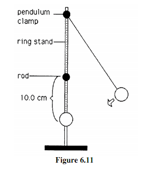

The pendulum bob in Figure 6.11 must circle
the rod interrupting its swing, and the string
must remain taut at the top of the swing. How
far up must the bob be raised before releasing
it to accomplish these goals?
Potential Energy = mgh
Kinetic Energy = 1/2mv^2
mgh = 1/2mv^2
I'm still unclear with what the question is asking for or how I'm suppose to solve it; though I'm guessing it deals with the conversion of kinetic energy into gravitational potential energy and maximum height. How the rod play into the question, or what the distance from the rod to the pendulum bob means, I've no idea. This sounds awfully similar to a conical pendulum, which a quick wikipedia search showed as pretty complicated.
So, how do?

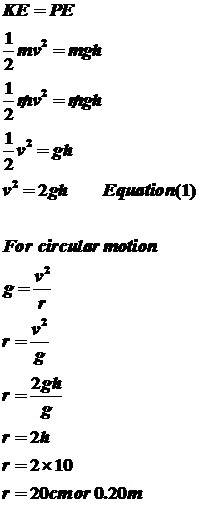

When the string hits the rod, it the bob will start circling the rod in a 10 cm radius circle. It won't reach the point 10 cm above the rod unless you release it from high enough. How high is 'high enough'?
Here is the Solution for you: Please click on the image. For more questions please send requests here...
