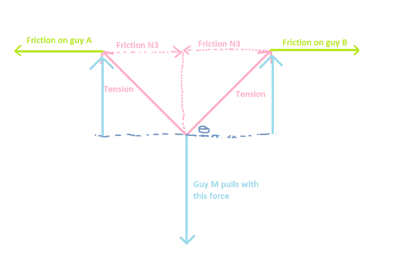

Is this diagram fine?
No, the friction on the two initial guys is parallel to their rope segments. Just draw the 3 force vectors from all 3 guys. They have to balance (vector sum is zero).
There are only 2 forces acting on A and B - friction and tension. They act in the opposite direction. In addition, neither A nor B does move, therefore, does it mean that Tension = Friction (with respect to magnitude)?
As the third guy starts to pull, the direction of the tension acting on the first two will change and so will the friction force on their feet. Friction is the same magnitude as the tension and in the opposite direction for each guy. You just need three lines on your vector diagram. The force from the third guy will be shared by the y components on the diagram of the forces that the other two guys exert.
Of course, if they started of with limiting friction, the third guy will make them slip until equilibrium is reached once again.
It's not very helpful, even if the above-mentioned errors are corrected.
A better approach might be to draw a diagram of the forces exerted on the point on the rope where the third guy touches it. Thus you have only three forces, call them ##\vec{T}_1##, ##\vec{T}_2##, and ##\vec{T}_3##. The three forces must sum to zero. Remember that just because Guys 1 and 2 have the same mass, it does not mean that ##\vec{T}_1## is necessarily equal in magnitude to ##\vec{T}_2##. As you say, those magnitudes are equal to the friction forces. Guy 1 might be wearing cleats and Guy 2 roller skates. If Guy 3 were to use a pulley with negligible friction then ##\vec{T}_1## and ##\vec{T}_2## would have equal magnitudes.
