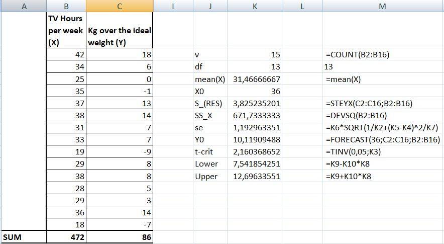

  4. Determine the confidence interval for the average weight in pounds for a child who watches television for $36$ hours a week and for a child who watches television for $30$ hours a week. Which confidence interval is greater and why?

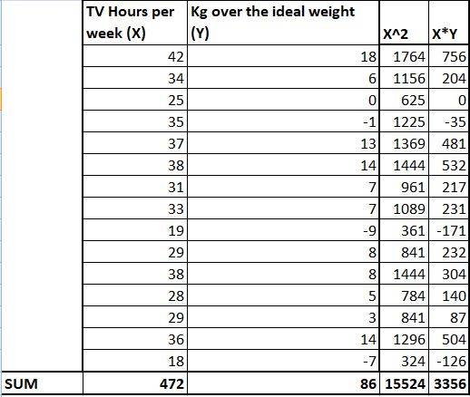

  1. At the beginning I calculated the following:
    Using these information we get:
    \begin{align*}&\nu =15 \\ &\overline{X}=\frac{\sum X}{\nu}=\frac{472}{15}=31.47 \\ &\overline{Y}=\frac{\sum Y}{\nu}=\frac{86}{15}=5.73 \\ &\hat{\beta}=\frac{\nu \sum \left (XY\right )-\left (\sum X\right )\left (\sum Y\right )}{\nu\sum X^2-\left (\sum X\right )^2}=\frac{15 \cdot 3356-472\cdot 86}{15\cdot 15524-472^2}=\frac{50340-40592}{232860-222784}=\frac{9748}{10076}=0.97 \\ & \hat{\alpha}=\overline{Y}-\hat{\beta}\cdot \overline{X}=5.73-0.97\cdot 31.47=5.73-30.5259=-24.80\end{align*}
    Therefore the linear regression equation with dependent variable the kg over the ideal weights is: \begin{equation*}\hat{Y}=0.97X-24.80\end{equation*}

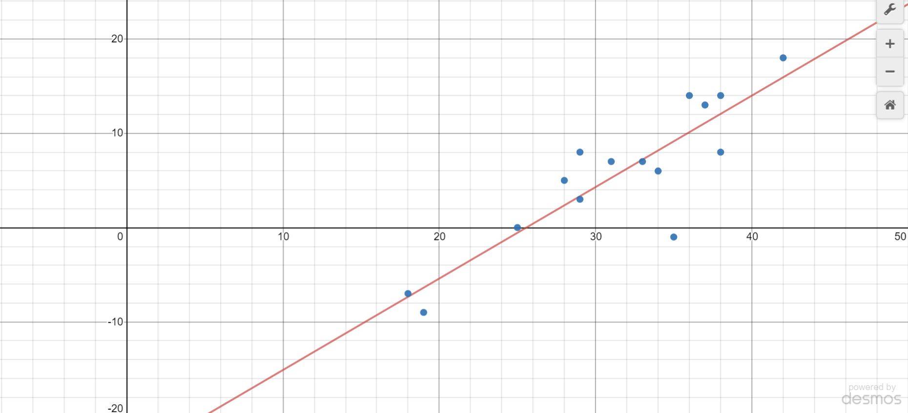

    The graph looks as follows:

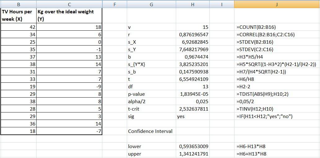

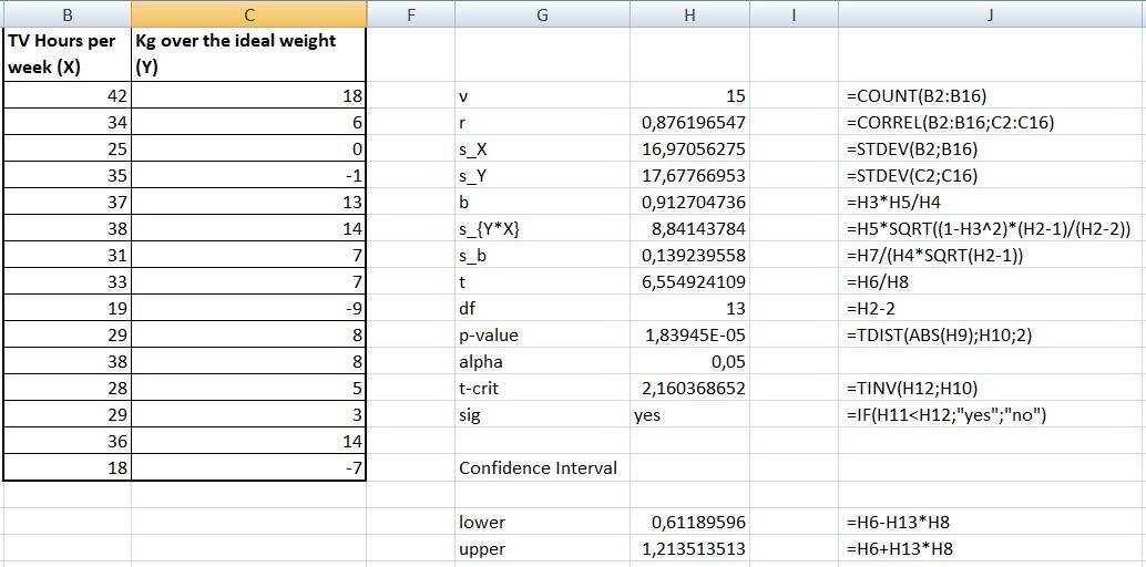

  2. We want to test the null hypothesis that the slope of the regression line is $0$.
    I found some notes and according to these I did the following:
    View attachment 9481 Since p-value < α (or |t| > t-crit) we reject the null hypothesis, and so we can’t conclude that the population slope is zero.
    Is this correct? (Wondering)
    But, according to these calculations we get an other slope than I got in the first question, or not? Here we have $b=0,91$ and in the first question I got $\hat{\beta}=0,97$.
    So have I done something wrong at the calculation of the linear regression equation? (Wondering)

mathmari said:
[*] We want to test the null hypothesis that the slope of the regression line is $0$.
Hey mathmari!
Let's rephrase that... we want to test the alternative hypothesis that the slope of the regression line is not $0$. (Nerd)
Is this correct?
Since we have a 2-sided test we need to compare the p-value with α/2.
If it is below - and see below for an apparent calculation mistake - then we conclude that the slope is significantly different from zero.
Or put otherwise, that there is a significant linear correlation between X and Y.
Note that we can never conclude that the population slope is 0. At best we do not have sufficient information to conclude that it is different. (Nerd)
Looks as if there is a mistake.
I get different values for s_X and s_Y. I have s_X=6.92 and s_Y=7.648.
Perhaps the excel range was not set correctly? (Wondering)

Ah yes, I found my mistake at the commands at Excel.
Now I get:
View attachment 9484So now it is the same slope as I found in the first question! (Whew)

mathmari said:
So do we have the following?
Since p-value < α/2 (or |t| > t-crit) we reject the null hypothesis, and so we conclude that the slope is significantly different from zero.
I've just noticed that you've used [M]=TDIST(x, df, tails=2)[/M] to calculate the p-value. If I'm not mistaken it means that the factor 2 has already been taken care of so that we can compare the p-value and α directly. :eek:
And yes, we conclude that the slope is significantly different from zero. (Nod)

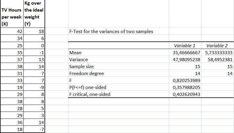

I used in Excel the "F-Test for the variances of two samples" and I got the following: View attachment 9485
Is this correct, i.e. did I give the correct inputs? (Wondering)
I don't think so.
It appears you have compared the variances of the inputs and the outputs.
But that does not really say whether they are correlated or not does it? (Worried)
Perhaps we should search for what kind of F-test we can do within the context of a linear regression.
It should compare the 'explained' variance with the 'unexplained' variance. (Thinking)

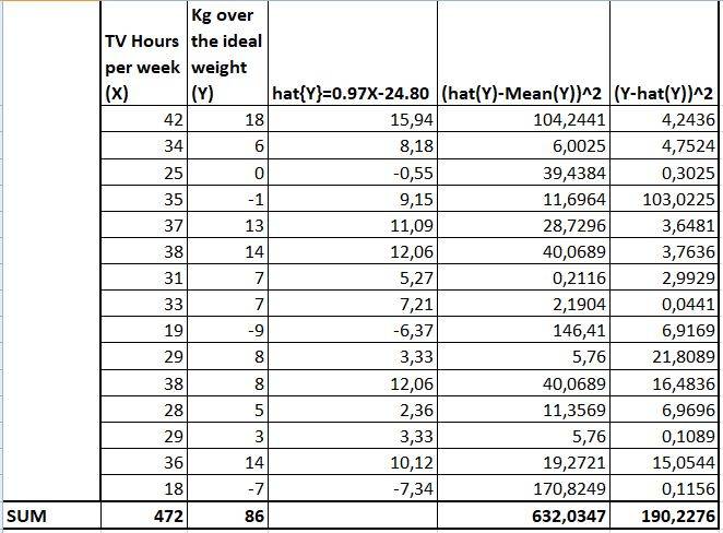

The explained variance is the sum of the squared of the differences between each predicted Y-value and the mean of Y.
The unexplained variance is the sum of the squared of the differences between the Y-value of each ordered pair and each corresponding predicted Y-value.
Right? (Wondering) Is the F-value the fraction of these two values?
If yes, then we have the following:
\begin{equation*}F=\frac{\text{explained variance}}{\text{unexplained variance}}=\frac{632.0347}{190.2276}=3.32252\end{equation*}
(Wondering)
Right?
Those are the sum-squared values, typically abbreviated as SSM and SSE.
To find the variances we still need to divide by the corresponding degrees-of-freedom (DFM and DFE) don't we? (Wondering)

So using the table of post #10 we get
\begin{align*}&SSM=632.0347 \\ &DFM=2-1=1 \\ &SSE=190.2276 \\ &DFE=15-2=13 \\ &MSM=\frac{SSM}{DFM}=\frac{632.0347}{1}=632.0347 \\ &MSE=\frac{SSE}{SFE}=\frac{190.2276}{13}=14.6329 \\ &F=\frac{MSM}{MSE}=\frac{632.0347}{14.6329}=43.1927\end{align*}

Applying thesame methodas before I get that the confidence interval for the case of 30 hours is $[2.130030132, \ 6.498790828]$.
Looking at your graph in post #1, that looks about right. (Nod)

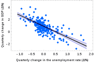

The wiki article explains that the range of the confidence interval has 2 parts:
  1. The error due to uncertainty in estimated slope ($\hat\beta_1$) and y-intersection ($\hat\beta_0$). This error is the least close to the center, and grows bigger away from the center.
  2. The error due to scattering from unexplained sources, which is assumed to be normally distributed with equal variance everywhere.
They also show a picture with the confidence band that has a hyperbolic shape (unrelated to this problem):
As you can see, the band is narrowest at the mean X-value, and grows wider in both positive and negative directions.
And indeed, 30 hours is closer to the mean X-value of 31.47 than 36 hours. (Thinking)
