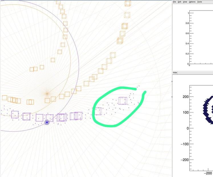

I want to perform RK4 between the first and second clusters and fill the positions in a histogram.
I can't make any sense of this. Could you please elaborate on what you want to solve?
this is what I want to solve. In the image, the cubes (circled in green)are the clusters with positions (x,y,z). I want to calculate the small points between cluster 1 and cluster 2 using the rk4 method.
I'm sorry, but this is not helpful at all. What differential equations are you solving?
