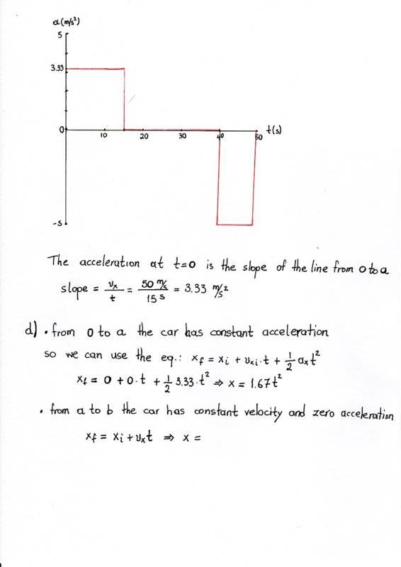

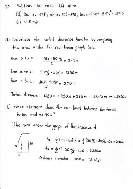

Figure P2.43 represents part of the performance data f a car owned by a proud physics student. (a) Calculate the total distance traveled by computing the area under the red-brown graph line. (b) What distance does the car travel between the times t=10s and t=40s?
(c) Draw a graph of its acceleration versus time between t=0 and t=50s
(d) Write an equation for x as a function f time for each phase of the motion , represented by the segments 0a, ab, and bc.
(e) What is the average velocity of the car between t=0and t=50s?
See at solution
Hi. My question is for now why the equation of x as a function of time for phase of motion ab is ##x=50t-375##?
Shouldn't that be ##x=375+50t##?
What are the values of ##x## and ##t## at point ##a##? Do these values satisfy your equation?
At point a the value of x=375m and value of t=15s.
These values don't satisfy my equation.
But they satisfy the equation ##x=50t-375##.
Right. Can you see why your equation is not correct?
No. Can you explain?
Keep in mind that the symbol ##t## denotes the time that has elapsed since the beginning of the motion, not the time that has elapsed since reaching point ##a##. Your equation would be correct if written in the form
x = 375 + 50##\Delta t##
where ##\Delta t## is the time elapsed since reaching point ##a##.
