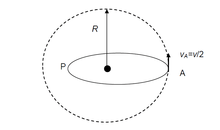

Ok, I think I understand. I am also working on a another question where I am given:
And asked to find the velocity at point P, which is the perigee. I assume A is the apogee. My question is, How can I relate total energy to find the velocity at this point?
What is v? I'm guessing here, but is it the velocity of a circular orbit with radius R?
Yes. At the point A, it begins to take the ellipse shaped path and decelerates to a velocity of v/2

You can use the conservation of angular momentum. at apogee and perigee the angle between the momentum and the force is 90 degrees, so
M Va Ra = M (v/2) R = M Vp Rp. You also need to relate R = Ra to semimajor axis and the eccentricity.

Neither eccentricity nor semi-major axis are given in this case (assuming that you are addressing the problem of post #9).
I've suggested to the OP that this problem should be relocated to a separate thread since it is a new, different question from the original problem that started this thread. We should await its appearance in a new thread and not discuss it further here.
