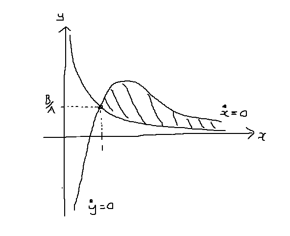

I have found fixed point to be ##(1, \frac{B}{A})##. I have plotted the graphs of ##\dot x = 0## and ##\dot y = 0##. Does bifurcation occur at ##B_H = 0##? Because when that happens the y=intercept of the fixed point approaches ##0##.
How do I find the period of the limit cycle surrounding the trapping region?

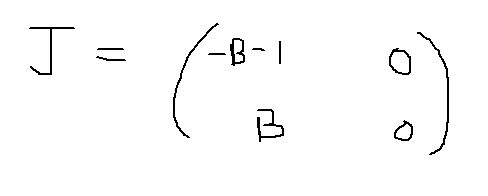

I tried that, and also tried a different approach by finding the eigenvalues of the Jacobian.
Jacobian Approach
The jacobian matrix is
Eigenvalue is ##\lambda = 0, -(B+1)##.

Does bifurcation occur at ##B_H = 0##? Because when B=0, the trapping region disappears, i.e. no limit cycle.

But from the jacobian I have found the eigenvalue to be ##\lambda = 0## or ##\lambda = -(B+1)##. For positive values of B, the eigenvalue has to be real.

And how did you get that Jacobian? It looks wrong.

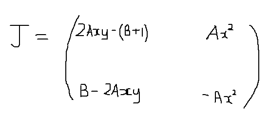

Thanks for working with me on this. I got the jacobian by finding the first row using ##\frac{\partial \dot x}{\partial x }= -(B+1)## and ##\frac{\partial \dot x}{\partial y} = 0##, and the second row using ##\frac{\partial \dot y}{\partial x } = B## and ##\frac{\partial \dot y}{\partial y } = 0##. Linearized. I should linearize the jacobian to find the eigenvalues, right? All the questions I have been doing so far are like that.

##\frac{\partial \dot x}{\partial y} = 0## is wrong.
Working with the Jacobian matrix yields the same result as the method you started to follow. Go ahead with it.

So I shouldn't linearize the jacobian from the start? So we have ##\frac{\partial \dot x}{\partial x} = 2Axy - (B+1)## and ##\frac{\partial \dot x}{\partial y} = Ax^2## and ##\frac{\partial \dot y}{\partial x} = B - 2Axy## and ##\frac{\partial \dot y}{\partial y} = -Ax^2##. This gives the jacobian matrix to be:
Expanding out to find eigenvalues, we have
[tex]\lambda^2 + \lambda(A-B+1) + A = 0 [/tex]
For the eigenvalues to be imaginary, we require
[tex](A-B+1)^2-4A = 0 [/tex]
[tex]A - B + 1 = \pm 2\sqrt A[/tex]
[tex]B_H = A + 1 \pm 2\sqrt A[/tex]
Substitute x=1 and y=B/A

No, it is not true. Use the quadratic formula. When do you get pure imaginary solutions?

For pure imaginary solutions, we require ##\frac{-b}{2a} = 0## and ##b^2-4ac <0##, so that means ##B=A+1##.
Therefore the displacement equation becomes ##\dot v = - Av##. ##T = \frac{2\pi}{\sqrt A} =\frac{\pi}{\sqrt{B-1}}##.
