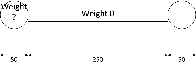

Just so we are really talking about the same pendulum:
you didn't tell us what m is and I don't understand how this is a pendulum. Where is the axis of rotation ?
How can it oscillate along the "line of centres"? and perpendicular to it ?
Hi BvU,
We weren't given m, and it doesn't make much sense to me either. When I read the question initially, that was the picture I had in my head. However, from reading it again, I think they're attached on the same end? Just simply because it said "one on either side of its lower end," not ends. To be honest, the book is very poorly worded at times. As regards to m, could it not be canceled with the lower line m in the equation? Maybe it's total mass of the system? I apologise for the vagueness of the question by the way, it's not very clear.

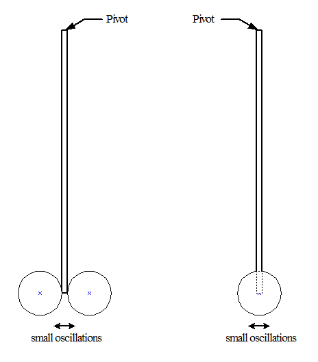

@BvU I think the two cases have the spheres at the same end of the rod, the difference being the plane of oscillation:
Likes BvU
@gneill Hi, thanks for the diagram, that's the picture I had in my head. Am I on the right track with my equations or is there something I'm forgetting about?

I think you're on the right track, but you should be careful about your moment of inertia expressions. Be sure to carefully account for the displacement distance in the parallel axis theorem for each case.
