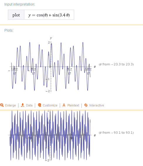

Interesting potential. For a=b and c = 3.4 Wolfram Alpha will plot your function,
http://www.wolframalpha.com/input/?i=plot+y+=+cos(theta)+++sin(3.4xtheta)
Change c.

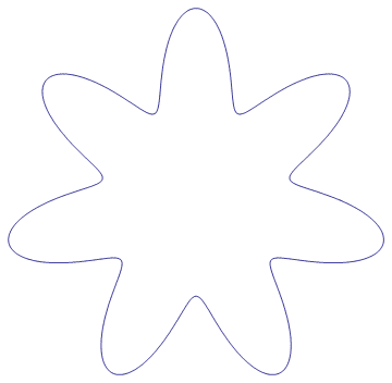

To be clear, it's about an angular (thus periodic) potential that can hinder a quantum rotor.
As an example, I show here the case of ## \hat{V}(\theta)\,=\, 3\,-\,sin(7\,\theta)##.

So the word "periodic" has two different senses, that I want to understand. However, it stays really blurred for me. In looking at the case of one dimension as you shown, mathematically, we cannot make a difference between:
## V(x) = a cos(kx) ## and ## V(\theta) = a cos(n \theta)##, since ##\theta## and ##x## are dummies variables.
So I am troubled when the first gives band structure and the second doesn't.

[itex]x[/itex] and [itex]\theta[/itex] are not interchangeable, though, so they aren't completely "dummy variables". In 1-D quantum mechanics, it is assumed that space is described by a coordinate [itex]x[/itex] that runs from [itex]-\infty[/itex] to [itex]+\infty[/itex]. In contrast, the angular variable [itex]\theta[/itex] runs from [itex]-\pi[/itex] to [itex]+\pi[/itex], and the point [itex]\theta = -\pi[/itex] is identified with the point [itex]\theta = +\pi[/itex]. These differences lead to different constraints on the wave function. In terms of [itex]x[/itex], it must be the case that [itex]lim_{x \rightarrow \pm \infty} \psi(x) = 0[/itex]. In terms of [itex]\theta[/itex], it must be the case that [itex]\psi(\theta) = \psi(\theta + 2\pi)[/itex]. So they are very different types of variables, and they have different consequences.
On the other hand, if you demand that EVERYTHING be periodic in [itex]x[/itex] with period [itex]L[/itex]---the wave function, the potential, everything---then the distinction disappears; In that case you can identify [itex]x[/itex] with the angular variable [itex]\theta = \frac{2\pi x}{L}[/itex].
