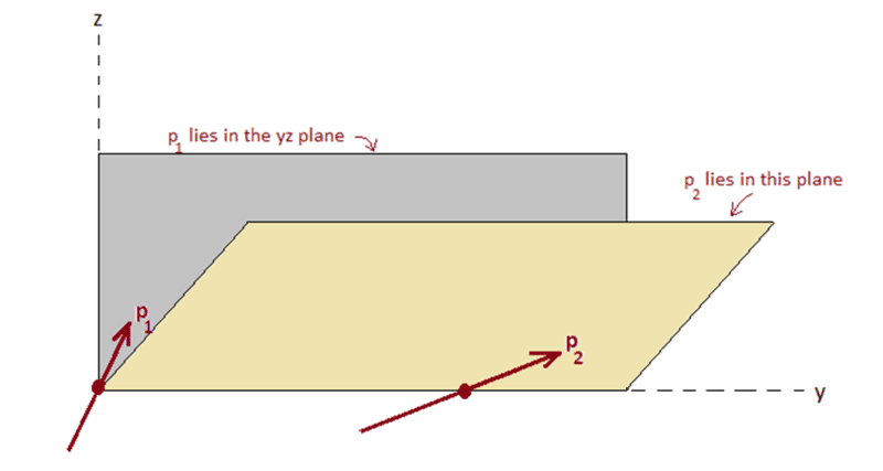

I am trying to derive the dipole-dipole interaction derivation, which is:
U=(-p1p2/4πϵ_0) (1/z^3) ((2cosθ_1cosθ_2)− (sinθ_1sinθ_2cosζ))
Where p1 and p21 are the two dipole moments, r is the distance between two dipoles on the y axis, θ_1 and θ_2 are the angles between the z axis and dipoles, and ζ is the dihedral angle
I am using U = -p2 * E_1 to derive the equation, where E_1 is the electric field of p1 and * is the dot product
So far, I have deduced E-1 in spherical coordinates as:
E_1= (1/4πϵ_0)(1/r^3) (2cosθ r + sinθ θ)
Where the bolded r and θ are the unit vectors in spherical coordinates.
Now from this, I have problems:
  1. How do I formulate p2 in spherical coordinates
  2. How do I dot product two vectors of spherical coordinates
See above
I have tried to convert E_1 into Cartesian, but it won't solve it if I don't know how to formulate p2

Did you mean to say that θ1 and θ2 are angles measured relative to the y axis?
You can rotate your xyz axes about the y-axis so that p1 lies in the yz plane.
Can you draw the vectors r and θ at the location of p2 in the above diagram?
Then try to find expressions for the r and θ components of p2.
