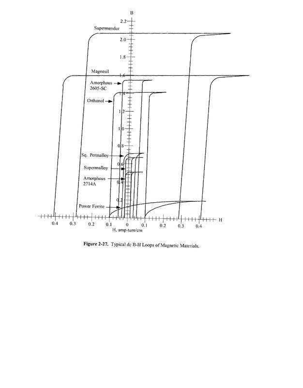

I would like to ask you something about the attached image. in particular on the amorphous material 2605-sc.
on the ordinate axis there is the quantity B which corresponds to the amount of magnetic flux in tesla when the material is in saturation. well I do not understand if they are tesla if they are a thousand tesla or micro tesla.
you think ?
arivel said:
... on the ordinate axis there is the quantity B which corresponds to the amount of magnetic flux in tesla when the material is in saturation.
Not quite. The SI unit of magnetic flux, B, is the weber, Wb.
The SI unit of flux density is the tesla, T, which has dimension of Wb / m².
The area of the magnetic path through which B flows is important, as it is the flux density through the material that determines the point where the material saturates.
Since the ordinate is labelled, B, it suggests the sectional area of the material under test has been standardised. If the numbers on the vertical axis are to make sense, then I think you must treat them as being flux density, simply tesla.
Where is the Fig 2-27 from? Maybe examination of the original document will explain the situation.
