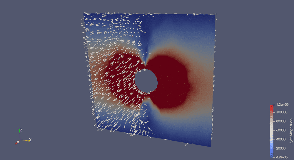

On my side, I have adapted the example code I linked above for a spherical magnet. Here's what I get for the B field (it's a slice of 3D space. The arrows show the field's direction).
Something is obviously wrong. I have tried several different things, like considering a current density (kind of guessing the electromagnet, which should be a dipole if the sphere is uniformly magnetized), considering no current density and solving for Laplace equation for each of the components of the potential vector, and then retrieve the B field by taking the curl of it (it is not expensive computationally, at least for this steady state configuration). I have tried different boundary conditions for the potential vector, either on the sphere itself, the faces of the box (almost equivalent to imposing conditions at infinity), etc. But I could not reproduce the magnetic field I expect, which should be very similar to the Earth's one.

This problem has drained my energy today. I must be solving the wrong equation(s) or messing the boundary conditions somehow.
What I do, in my code, is solve 3 independent PDE's, one for each component of the potential vector. Namely, I solve ##\nabla \cdot (1/\mu_0 \nabla A_z) = 0## (because ##J_z=0##) and similarly for ##A_x## and ##A_y##. The only difference between these equations is the boundary conditions, which I take as ##A_z## being some non zero constant over the sphere (magnet's surface) and ##A_y## and ##A_x## as zero over the sphere (I also tried several variants, such as taking Dirichlet boundary conditions for ##A_i## at the wall's surface which corresponds to the limits at infinity.) Then the ##\vec B## field is simply the curl of ##\vec A##.
I couldn't get anything close to what it should, yet.
Is there something blatantly wrong with my approach? Of course I might have messed up in the code itself, but if the physics of the problem is wrong, then I am doomed from start.

vanhees71 said:
I don't understand this question. Here you just solve for ##\vec{A}## given the surface-current density. The only boundary condition is that you make ##\vec{A} \rightarrow 0## at ##\vec{r} \rightarrow \infty##.
Thanks once more, I'll try your suggestion and get back to you as soon as possible afterwards. Might take me a few days to get the free time to do it.
I am currently back on this project for some minutes. I see, thanks a lot. Now that I am in front of my code, I don't think it is as easy to implement. Essentially the equation is the Laplace equation in the whole volume of interest except at the surface of the sphere where the (vector) Laplacian is worth the surface current. I'm not an expert with FEniCS, but I think I should find a way to get a boundary condition of ##\vec A## over the surface of the sphere (be it Dirichlet, Neumann, Robin or possibly of other kinds). There is one such approach described in https://comphysblog.wordpress.com/2018/09/06/tem-mode-analysis-with-fenics/. I might have to follow a similar path.
Likes vanhees71
