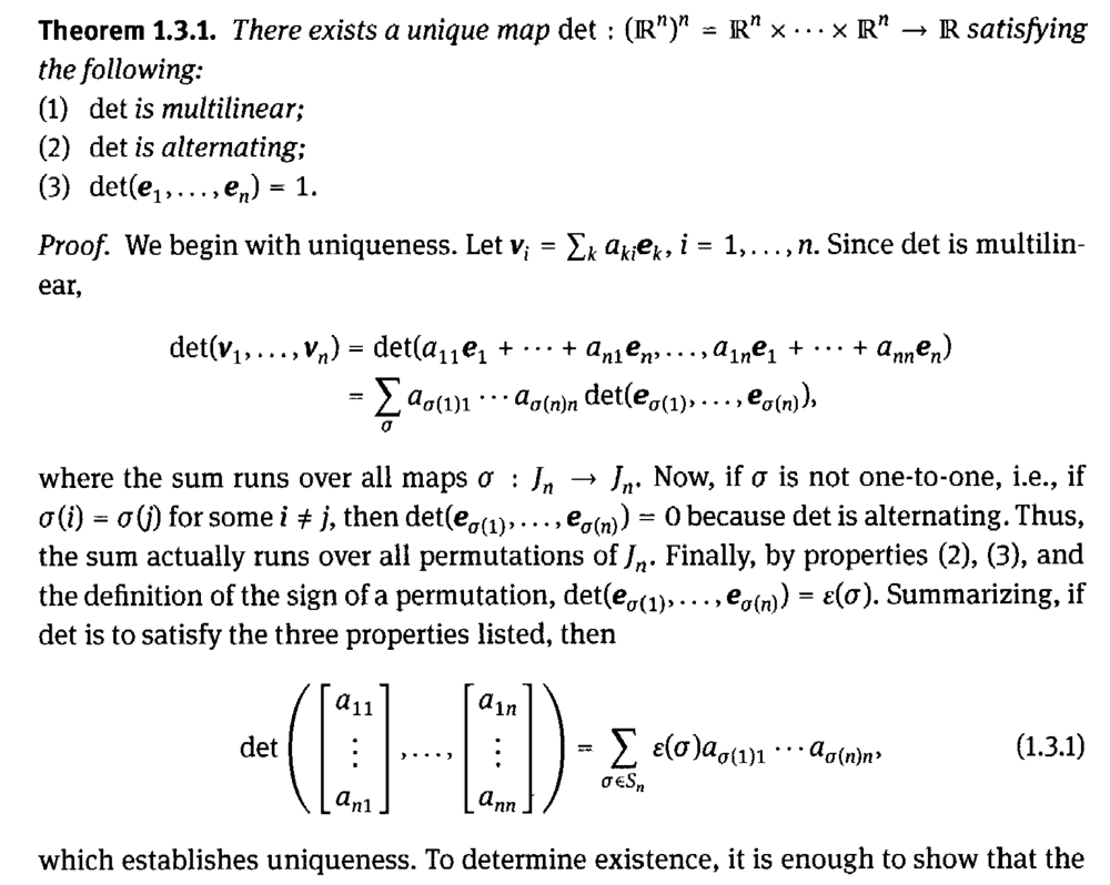

I am reading Gerard Walschap's book: "Multivariable Calculus and Differential Geometry" and am focused on Chapter 1: Euclidean Space ... ...
I need help with an aspect of the proof of Theorem 1.3.1 ...
The start of Theorem 1.3.1 and its proof read as follows:
I tried to understand how/why
##\text{det} ( v_1, \cdot \cdot \cdot , v_n ) = \sum_{ \sigma } a_{ \sigma (1) 1 } , \cdot \cdot \cdot , a_{ \sigma (n) n } \ \text{det} ( e_{ \sigma (1) } , \cdot \cdot \cdot , e_{ \sigma (n) }##
where the sum runs over all maps ##\sigma \ : \ J_n = \{ 1 , \cdot \cdot \cdot , n \} \to J_n = \{ 1 , \cdot \cdot \cdot , n \}##
... so ...
... I tried an example with ##\text{det} \ : \ (\mathbb{R}^n)^n \to \mathbb{R}## ... ...
so we have ##v_1 = \sum_k a_{ k1 } e_k = a_{11} e_1 + a_{21} e_2##
and
##v_2 = \sum_k a_{ k2 } e_k = a_{12} e_1 + a_{22} e_2##and then we have
##\text{det} ( v_1, v_2 )####= \text{det} ( a_{11} e_1 + a_{21} e_2 , a_{12} e_1 + a_{22} e_2 )####= a_{11} a_{12} \ \text{det} ( e_1, e_1 ) + a_{11} a_{22} \ \text{det} ( e_1, e_2 ) + a_{21} a_{12} \ \text{det} ( e_2, e_1 ) + a_{21} a_{22} \ \text{det} ( e_2, e_2 )####= \sum_{ \sigma } a_{ \sigma (1) 1 } a_{ \sigma (2) 2 } \ \text{det} ( e_{ \sigma (1) }, e_{ \sigma (2) } ) ##
##\sigma \ : \ J_n = \{ 1, 2 \} \to J_n = \{ 1 , 2 \}## ...... ... that is the sum runs over the two permutations
##\sigma_1 = \begin{bmatrix} 1 & 2 \\ 1 & 2 \end{bmatrix}## and ##\sigma_2 = \begin{bmatrix} 1 & 2 \\ 2 & 1 \end{bmatrix}##BUT how does the formula ##\sum_{ \sigma } a_{ \sigma (1) 1 } a_{ \sigma (2) 2 } \ \text{det} ( e_{ \sigma (1) }, e_{ \sigma (2) }## ...
... incorporate or deal with the terms involving ##\text{det} ( e_1, e_1 )## and ##\text{det} ( e_2, e_2 )## ... ... ?Hope someone can help ...?
Peter

Quick reply (I will have more time this evening, if necessary):
The author seems to overcomplicate the case. Just define the determinant as the sum that runs over all permutations in the first place. Then you don't even need to worry what happens with none-injective maps.
As for your question ##\det(e_1,e_1) = 0 = \det(e_2,e_2)##. This easily follows by the defining determinant properties.

where the sum runs over all maps ##\sigma \ : \ J_n = \{ 1 , \cdot \cdot \cdot , n \} \to J_n = \{ 1 , \cdot \cdot \cdot , n \}##Peter
This is just the definition of multilinearity: it means you can pull out scaling factors. For 2 variables : ## M( c_1a_1+ c_2a_2)= c_1M(a_1+ c_2a_2)= c_1c_2M(a_1+a_2) ## For k variables : ## M( c_1a_1+...+c_ka_k)= c_1M(a_1+ c_2a_2+...+c_ka_k)= c_1c_2M(a_1+a_2+ c_3a_3+...+c_ka_k)=...c_1c_2...c_kM(a_1+a_2+...+a_k) ## According to the exercise, if a map is multilinear, equal to 1 on the ##e_i## and alternating, then it must be the determinant.

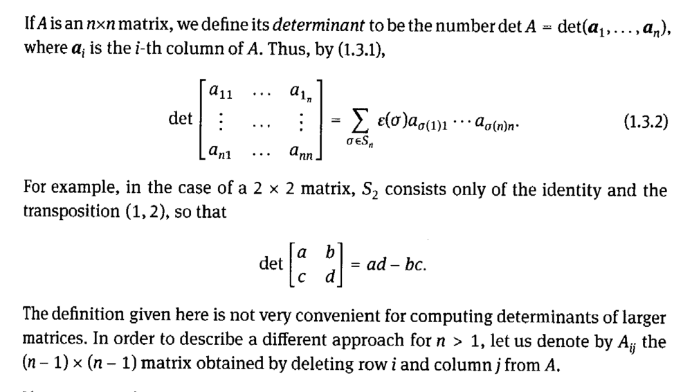

Just for interest ... after proving Theorem 1.3.1 Walschap defines a determinant as follows:
Peter
