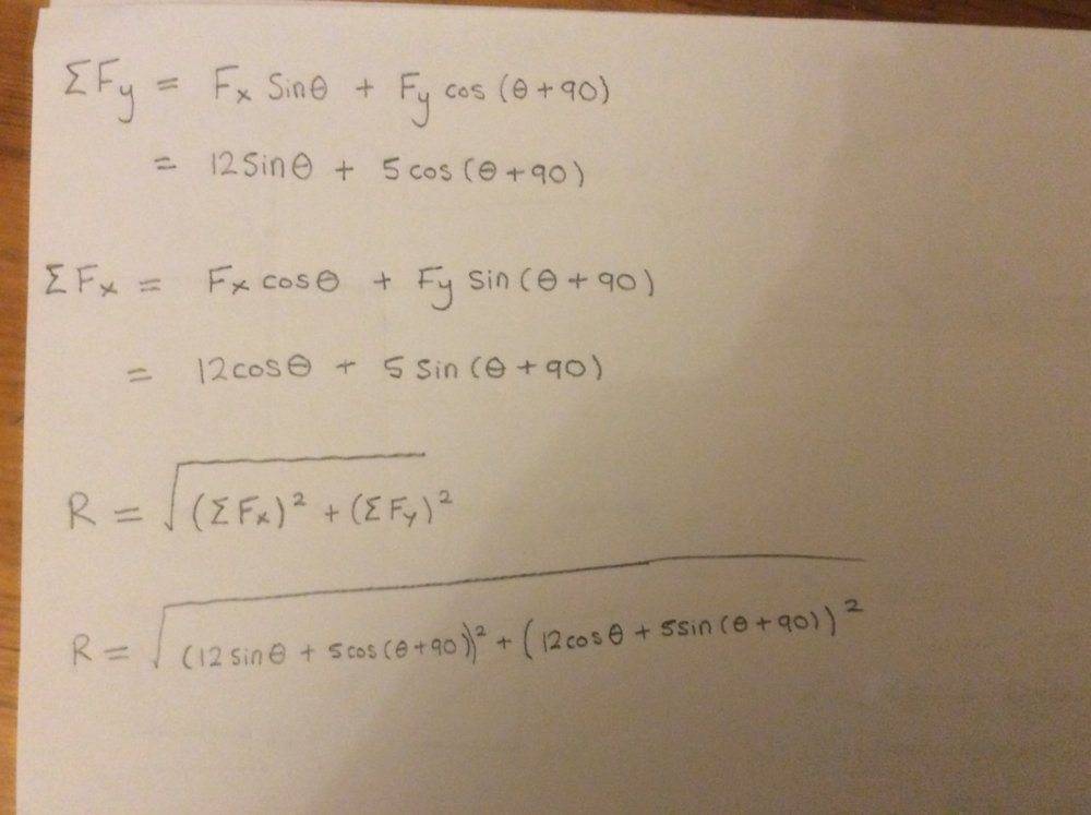

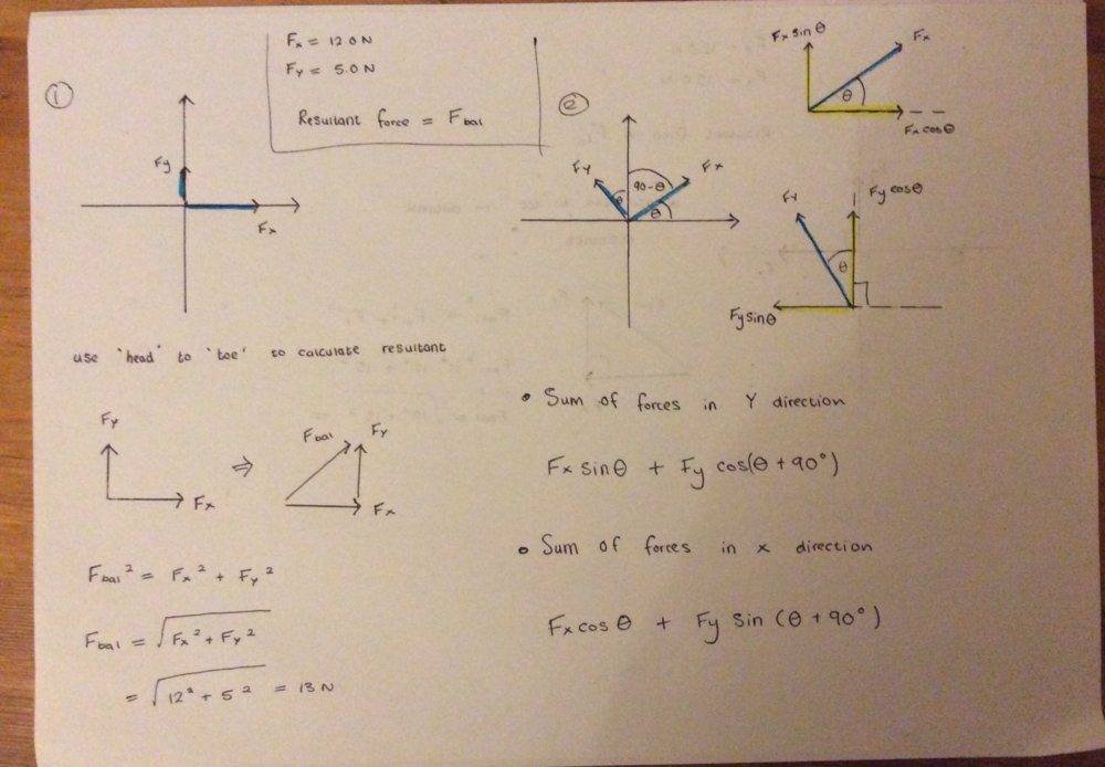

So I got a question shown below here and I’m struggling in what the question is trying to say here and what it wants me to give?
Here is what I done
For when resolving the individual x and y component of forces, my angle has always been measured counter clockwise from the positive x-axis initially.
Any help would be really great! Thanks

For the first case, when the 5N force is acting directly along the y-axis and 12N force acting directly along the x axis. Then the angle between the positive x-axis and resultant force is 22.6 degrees from using basic trig.
For the second case, I believe both forces get rotated by some angle theta counter clockwise from the positive x axis. Thus I had tried to resolve both forces into its horizontal and vertical components again leading me to get 4 smaller orthogonal forces. I then grouped the horizontal and vertical components separately. To find this third balancing force, I used Pythagoras. I had left this resultant force in abstract form as the theta angle is unknown here
No, no need to rotate those forces. They retain their original orientation. You simply have to add another force to balance their resultant.

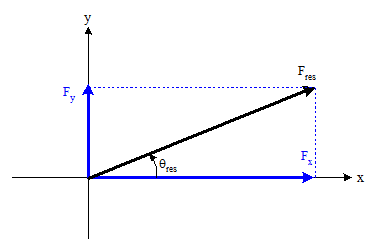

Draw your original forces and form the resultant:
Now redraw showing only the resultant (remove the original two forces as the resultant does the same thing as those two original forces). Now, what force would you need to apply to cancel out that resultant?

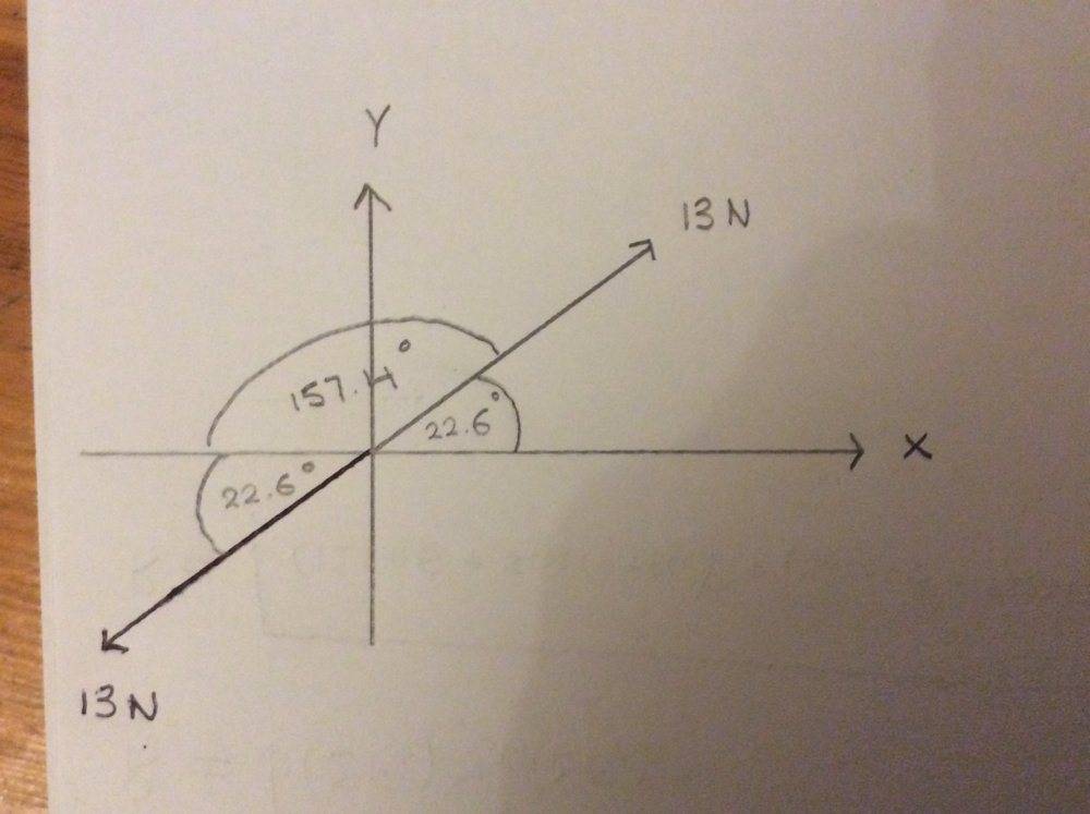

I see now. So to add an additional force that will counteract that resultant would be to apply a force that is of the same magnitude as the resultant but in the opposite direction to the resultant. So the force extra force that should be exerted on the object is a 13N force which is 202.6 degrees from the +ve x axis. So I guess this ensures that when all the forces are applied, including the extra force, new resultant comes out as zero and the object stays stationary.

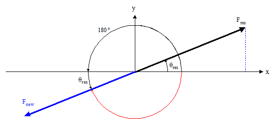

Right! Although I would likely look at the angles like this:
Usually we like to see angle values in the range ##-180\deg \le \theta \le 180 \deg##, so you can also specify the angle from the positive x-axis as a negative value going clockwise from the x-axis to the new force in the third quadrant (shown in red below):
Likes Bolter
Ahh so preferably the angle is -180 + 22.6 = -157.4 degrees. Which is noted to be the angle measured from the positive x axis, going in a clockwise direction. Got it :smile:
