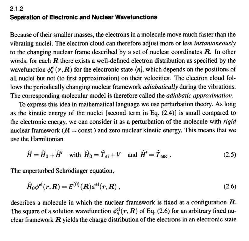

i am a the third year undergrad student and in this 2nd semester in my collage we should start taking quantum mechanics along with
molecular physics , our molecular physics professor choose a book that we are going to take which is " molecular physics by wolfgang Demtroder "
when i opened that book i found that it uses some advanced quantum mechanics like perturbation theory ... i found it really heavy for a student that just has some relativity intermediate quantum mechanics knowledge !
i started to get this perturbation theory thing ! but has some questions about this :

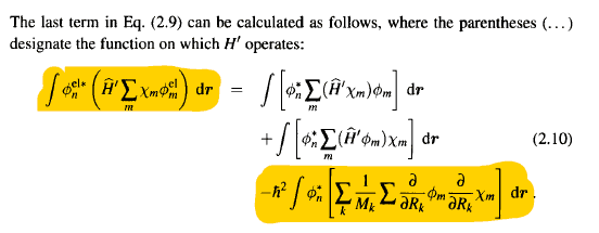

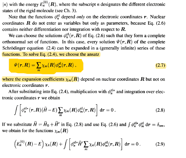

i get that he can represent the electronic distribution as a linear combination of functions with some coefficients that depend on the
position of the nuclei , how did he expand that integral and reached that partial derivative term its very unclear to me ?

This tells you that ##\hat{H'}## is the operator corresponding to the kinetic energy due to the motion of all of the nuclei. Suppose the ##k^{th}## nucleus has a mass ##M_k## and position ##\mathbf R_k##. Can you write down the kinetic energy operator ##\hat T_k## for this nucleus?
