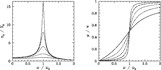

here u can see the classical picture (second one - right one). phase angle there is phi instead of theta (just another symbol but same meaning) and u can see it in dimensionless values. left picture is amplitude as a function of ω. IT makes sense. But i don't understand the second one.

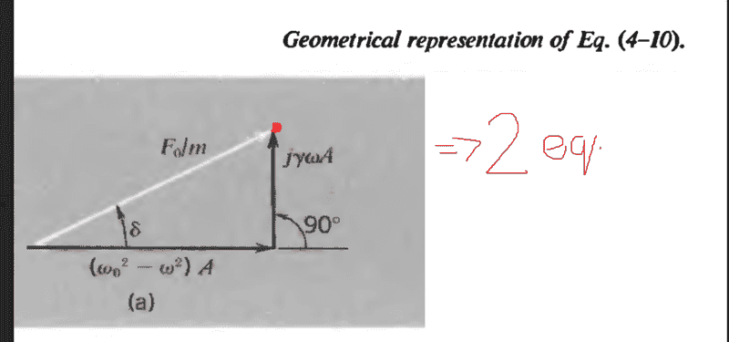

The equation that you get from setting the imaginary parts equal ## \gamma \omega A=\frac{F_o}{m} \sin{\delta} ##, tells you ## 0<\delta< \pi ##, if you go under the assumption that ## A>0 ##, which it must be from your formula for ## A ##. With this equation, it no longer allows you the freedom of taking the domain of ## \delta(\omega) ## in the subsequent ## \tan{\delta(\omega)}=\frac{\gamma \omega}{\omega_o^2-\omega^2} ## formula as being from ## -\frac{\pi}{2} ## to ## +\frac{\pi}{2} ##.

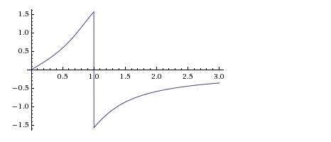

If i plot his=my solution for phase angle , the graph looks nonphysically discountious. Look:
(plotted
in dimensionless numbers)
However he does not present this incorrect grpah, he present the correct continuous graph
, although it does not correspond with his equation for phase angle. Its strange. He probably knows how graph of phase angle looks like, but his solution is certainly not OK.
