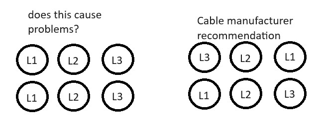

Hi
If the length of parallel medium-voltage cable runs is approximately 20 meters, and cable sheath is grounded only at one end, does it matter how the parallel phases are installed on the cable rack? If the straightforward installation method doesn't follow the rule for arranging the phases on the rack correctly, is there any significance to it in terms of cable load capacity or any other aspect?"

I think the idea here is to achieve equal current sharing in parallel conductors considering the complete circuit (i.e. return currents). Sharing is sensitive to small impedance variations (inductance) since the conductors are in parallel (I think). So the preferred distribution you showed has the three phases grouped together into two symmetric groups to achieve balance. The other grouping you showed has a significant difference between an L1-L2 current vs. an L1-L3 current path. How much this actually matters would depend on your specific installation, of course. 20m doesn't seem that long to me, but I guess it could matter for very high currents.

It's also not great for EMC for similar reasons (a bigger antenna loop).
Anyway, symmetry is good, minimum loop area is good.

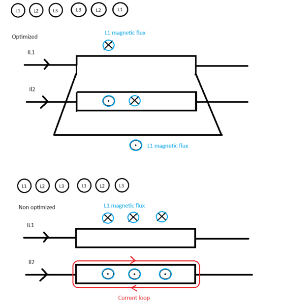

I agree, it has something to do with EMC, an electrician once told me that three phase transmission lines are triangular because the conductors are more closely spaced and the magnetic field strength is lower than when they are lined up. This also means that the transmission line has minimal inductance and produces minimal magnetic interference.

What I meant with my image in the previous message is that, in my opinion, a bundle of conductors of the same phase generates a larger magnetic field around the conductor bundle than an individual subconductor. This magnetic flux then passes through, for example, the loop formed by the L2 phase conductors. If the L1 phase is distributed on both sides of the L2 phase, then, in my opinion, the magnetic fields passing through the loop L2 phase conductor bundle would be in different directions, and one could think that no current would be induced in the L2 loop by its parallel conductors. The current flowing in the loop can cause heat, which would lead to a greater imbalance in impedances. It is possible that my theory is incorrect.
The proximity effect you mentioned could be at least a contributing factor to what causes the imbalance in parallel conductors. On the other hand, one could consider that this proximity effect affects each conductor pair in the same way, so the current imbalances between phases would be zero, even though there might be more losses in the conductors as a result of this. I could perhaps try to make a simple simulation and study how these aforementioned theories are reflected in it."

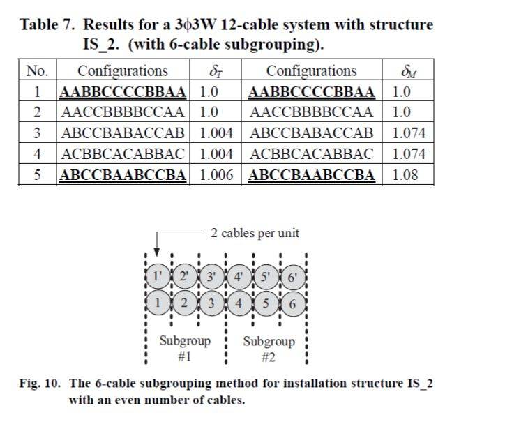

Calculated, according IEC 60287-2 [and -1], at 30oC air -no wind, no sun-current capacity is 1279A per cable, and you have 4 cables in parallel per one phase. If distance is 128 mm centre-line to centre-line for 20 m length the unbalance is negligible. If the cables are in touch-no clearance between cables- the arrangement is very important in order to decrease the unbalance.
If you will follow the cable arrangement as per fig.10, the unbalance will be the minimum, also.
See-for instance:
A CABLE CONFIGURATION TECHNIQUE FOR THE BALANCE OF CURRENT IN PARALLEL CABLES DISTRIBUTION by San-Yi Lee
https://files.engineering.com/downl...9b3b03d12&file=Balance_in_parallel_cables.pdf
That's the part that looks like your case

Ok, I will have a look of that document, seems to contain relevant information for this case.

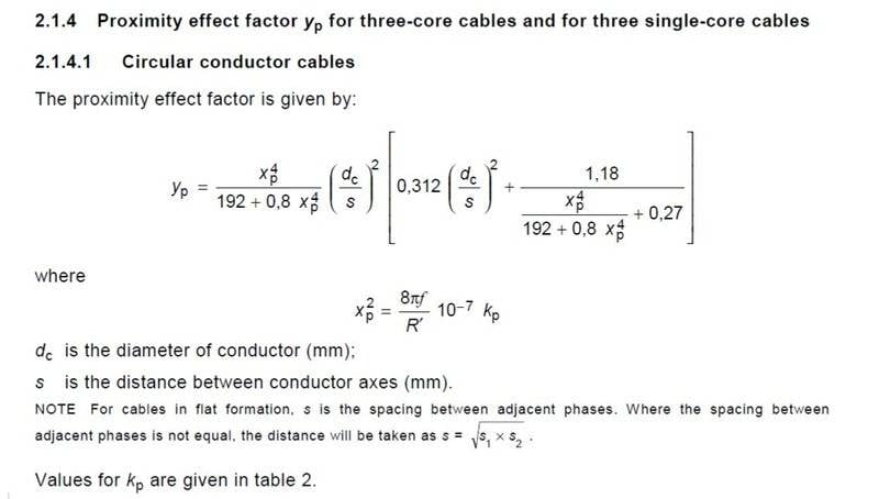

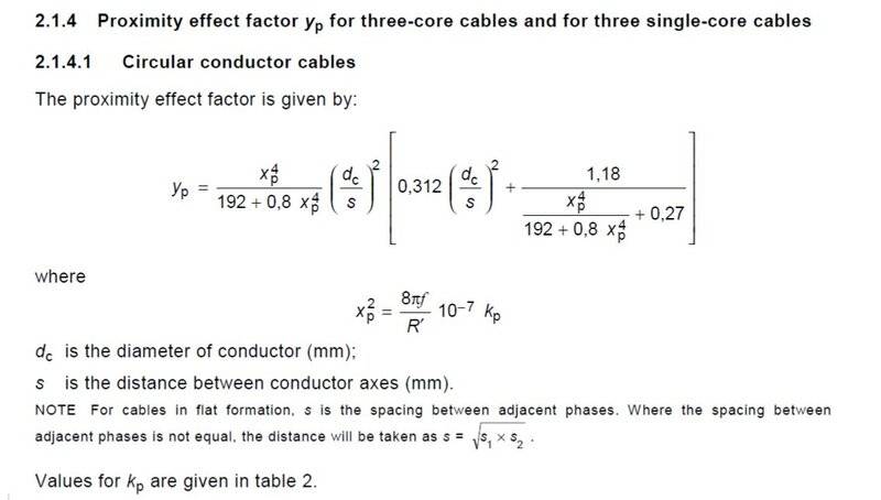

Skin effect and proximity effect it can be calculated according to IEC 60287-1-1 2.1.2 Skin effect factor ys and 2.1.4 Proximity effect factor yp for three-core cables and for three single-core cables

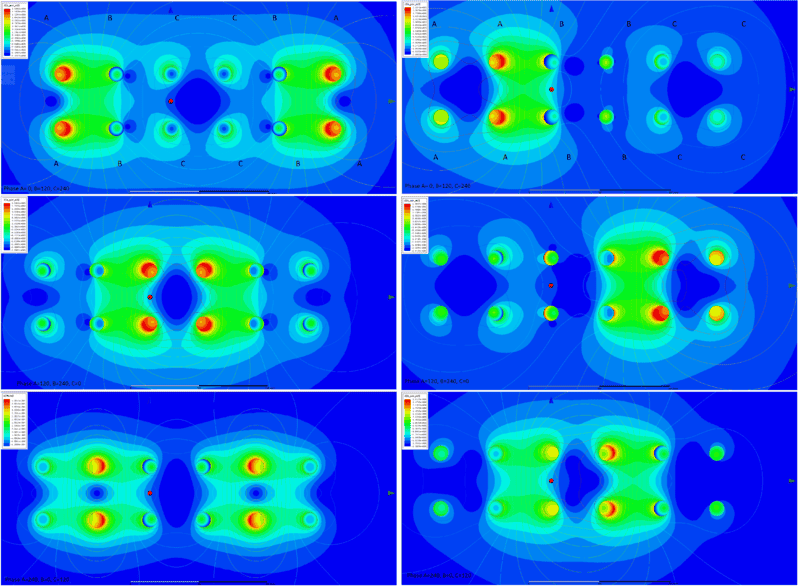

I made a simple current density simulation with Ansoft Maxwell, as there was an issue with the element limit in QuickField student version. In the image below, on the left, is the arrangement as per the 'balance of parallel cables' document, and on the right is a more unbalanced situation in terms of current distribution by default. Both have three different scenarios with a 120-degree phase shift. By comparing the results, it is clear that the left-side cable layout is balanced in terms of sub conductor current density, compared to the situation on the right. However, it remains somewhat unclear to me that the 'balance of parallel cables' document mentions that equations (1) and (2) do not include skin and proximity effects., yet the equations contain variables that define factors such as the distance between conductors. Thus, it remains unclear which phenomenon affects current distribution if it’s not proximity effect. In any case, the installation method according to fig.10 of the 'balance of parallel cables' document is beneficial for this substation project. In this way, the old installation can be preserved, and a mirrored second set of cables can be added alongside.
Likes alan123hk and DaveE
I haven't fully understood the details of San-Yi Lee's article, but I believe the reason for the uneven current flow in different wires of the same phase is the mutual impedance mentioned in the article. For example, it can be seen from Figure 1 in the article that the position distribution of all conductors belonging to the same phase or out of phase is completely asymmetric in space, so the mutual inductance between them is completely irregular, and the mutual impedance is actually caused by the mutual inductance.
In my opinion, if the current within the same wire accumulates on the left or right side, it should be classified as proximity effect. If you add the effects of skin effect and proximity effect, the overall situation may be more serious than mutual impedance alone. Fortunately, a good simulation software should comprehensively display the results including all factors.
I'm not sure about the exact arrangement in your simulation, can you tell me?

If you look that image closely there is letters for cable arrangement. There is four single core cables per phase. Current was 4000 A total per phase.
Left side:
ABCCBA
ABCCBA
Right side:
AABBCC
AABBCC
I think that my simulation model probably doesn't involve mutual impedance at all; instead, the currents are likely distributed based on their current phase angles and possibly due to proximity effects and, possibly, skin effect. There is some impedance matrix option in Maxwell, but i don't know how to use it correctly. Based on visual inspection, the results on the left side do appear significantly more symmetric. Indeed, the mutual inductance influenced by the magnetic fields of adjacent conductors is likely the reason for current distribution,as mentioned in the document, without taking into account proximity and skin effects. My English skills are somewhat limited, so I may miss some points.

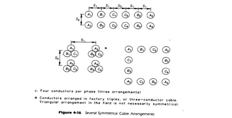

EPRI EL-5036-V4 Power Plant Electrical Reference Series Volume 4 Wire and Cable recommends an arrangement for 4 parallel cables [see attachment]
