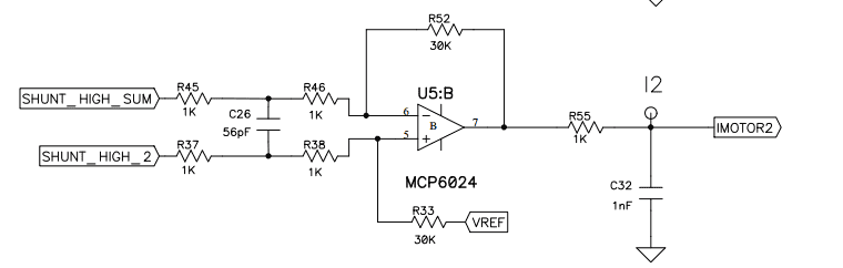

Phase current sensing and the phase delay
This is the phase current sensing circuit
Here the phase currents are converted to voltages by passing through shunt resistor and fed to the opamp. Two questions i have
a. Can I analyze the R45, R37, C26 as one filter circuit and the remaining as other circuit for gain?
b. The phase currents are converted into voltages after passing through shunt resistor and are available at the output of the opamp. Does the capacitor C26 add any phase delay?
R45, R37, C26 has a product of about 100 ns, so it will only remove RF.
Not really. The TC is small compared to R55 * C32 = 1 us, which is probably an antialiasing filter before an A to D converter.
The gain of the shunt amplifier is set by series 1k + 1k = 2k input, to 30k output, gain = x15.
