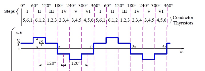

Calculate the phase currents for trapezoidal switching
For trapezoidal switching or 180 degree switching these are the waveforms when i referred to the website
180 switching
when i calculated the RMS value of the phase voltage it is Vp = 0.4714Vs
so assuming the
Vs = supply voltage = 20V
and each phase - phase resistance as per the data sheet is 0.57 Ohms. So, the current is 16.52 amps in each phase? Are my calculations correct? Please advise.
Show your assumptions
Now i understand that the currents also depend on the inductance and the back emf of the motor connected. But one doubt is if the applied voltage and the back emf are equal then 0 correct flow. How does it happen?
Sorry I don't understand this. Assumptions with regard to motor?
Yes all assumptions include RdsOn of source and complex load impedance for RMS current, backEMF @ RPM but a quick simulation on my part proves you are close to my answer for a pure 570m load of 16.46 Arms ... in theory, in practise is always different.
for +/- 13.33V with steps normalized to 1,2,1,-1,-2,-1.
There are harmonic differences with 8 phases and others, which do you think is best for cancellation? Considering magnetics are strong odd harmonics. Ask your prof.
