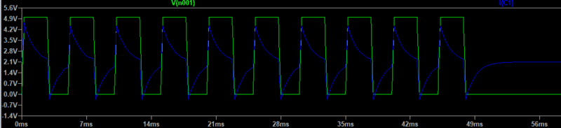

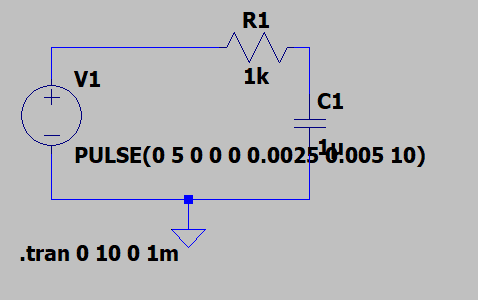

I simulated the below circuit to capture the phase delay between input voltage and output current in LTSpice
How do i measure the phase delay introduced due to capacitor?

The rule is that currents in a series circuit are ALWAYS in phase. So I'll ask you what can you conclude from that rule and the circuit you have drawn.
When you are using the term "delay" - which signals do you have in mind? Such a delay is the delay between two signals (voltage and/or current) resp. the corresponding phases of these signals,
When you remember your own definitions, you will know what you have to measure/simulate.
This would normally be done with sine waves, not square waves. This is because the phase delay depends on the signal frequency. A pulse waveform contains many frequencies. It still can have a phase shift, but it's complicated. So sine waves, which are a single frequency, often swept through a range to make a frequency response (Bode) plot, is what most EEs use.
In any case, you need to specify the conditions, like the input waveform, for phase delay to make sense.

It looks like you are using a Transient Analysis -- that is not the type of analysis that you should use to see the Frequency Domain characteristics of a circuit. Have a look at this article, and let us know what a better SPICE analysis mode would be... :smile:
https://techweb.rohm.com/know-how/simulation/7916/

A square wave will charge a capacitor up as soon as it is applied because it is similar to direct current.
Are you wanting to test the time constant, tau, as it is charging?
  • Skeptical
Likes DaveE
More accurately, a square wave will start to charge up a capacitor with the initial application of the first pulse. Subsequent pulses alternately start to discharge it and recharge it... (see the OP's transient SPICE simulation):
Likes hutchphd and Tom.G

As has been noted the term phase delay (better called phase lag) is defined as the response to a particular frequency sine wave. So your question is not well formulated. Please try again.
