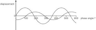

Two light waves of the same frequency are represented by the diagram.
What could be the phase difference between the two waves?
A 150°
B 220°
C 260°
D 330°
phase difference = phase angle in this diagram...
the diagram.
i found that the phase difference between them is 100º
but how is the answer 260
can someone please explain?

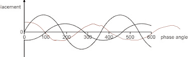

As a useful exercise you could draw 4 graphs, each with two waves. The first one with a phase difference of150 degrees, the others with 220, 260 and 330
drawing them, give me 5 mins and ill get back to you
this is what i got for 260º
what next??

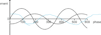

this one is for 220º
i still dont understand it... :(

The curves are ##\sin(\theta+\phi_1)## and ##\sin(\theta+\phi_2)##.
Suppose ##\phi_1+2\pi>\phi_2>\phi_1##. The phase difference is ##\phi_2-\phi_1##.
But ##\sin(\theta+\phi_1)=\sin(\theta+\phi_1+2\pi)##, so those are two representations of the same wave. So we could equally say the phase difference is ##\phi_1+2\pi-\phi_2##.
  • Wow
Likes hello478
If the phase difference between the first and the second is 100°, what is the phase difference between the second and first?
My two-pennies-worth…
On the Post 1# diagram, call the larger-amplitude wave ‘A’ and the smaller-amplitude wave ‘B’.
A passes through (0, 0). The next 'matching' point on B is (100º,0). So the phase difference is (100 – 0 =) 100º.
But you could equally well say:
B passes through (100º, 0). The next 'matching' point on A is (360º, 0). So the phase difference is (360-100=) 260º.
Remember that an angle of (say) +260º is the same as an angle of -100º. You can choose which wave (A or B) is the reference.
