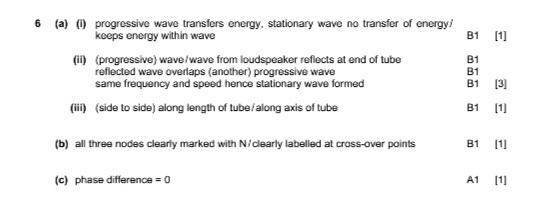

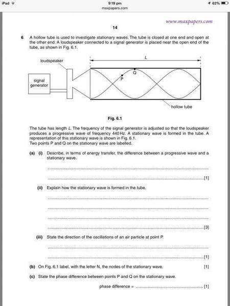

Q6c)
Why is the phase difference between two points in a stationary wave equals to zero?
I understand that a stationary wave is formed by two progressive waves which have the same amplitude, frequency, wavelength and speed, but traveling in opposite directions.
i hope you know that - every point on the string (in case of mechanical waves) is in simple harmonic motion
so for a string in resonance frequency (except fundamental) we have a part of the string moving with phase difference of ∏ (180°) with respect to the one adjacent to it (separated by a node).

But how does that link to the phase difference being 0? The points P and Q in the picture attached are not separated by a node.

So how does it link to question 6c)
This is the answer
Why a phase difference of zero?
This is the answer
Are the two points P and Q separated by a node?
AM
AM
No, they are not.
Janiceleong26 said:
No, they are not.
So they reach their maxima and minima at the same time as explained in my post #6 - ie. no phase difference. If they were separated by an odd number of nodes, they would be ##\pi## radians out of phase.
AM
AM
I see, thanks. But the two points in the question paper have different maxima / minima.. Do they still reach their respective maxima / minima at the same time too ?
The maxima and minima will depend on x but they will occur at the same time ie. when ##\sin\omega t## = 1 and -1. See my post #6.
AM
AM
Got it. Thank you very much !
