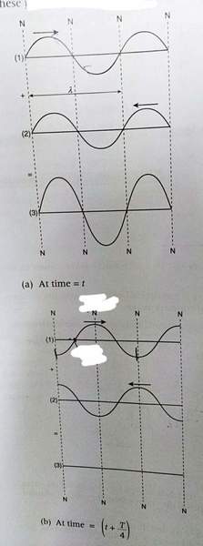

hi, i have attched some of the standing wave pattern at difefrent time. for time T= t/4 , yes, the phase difference is 180 degree shift , but when t=0 . there's no phase difference for the incident and reflected waves.
