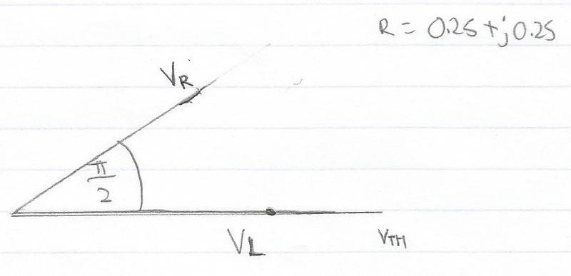

Ok, I am still not sure how the phasor diagram should look. Prior to this, the only phasor diagrams we have been taught is the general one for a capacitor and inductor.
Would it look like this?
No. Vth and VL are not in phase. VR and VL are in phase. Recall KVL. Sum of the voltage drops across Thevenin resistance, Thevenin reactance and load is equal to the Thevenin voltage. You know the magnitudes of three of them and their phase relation.

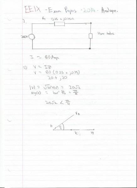

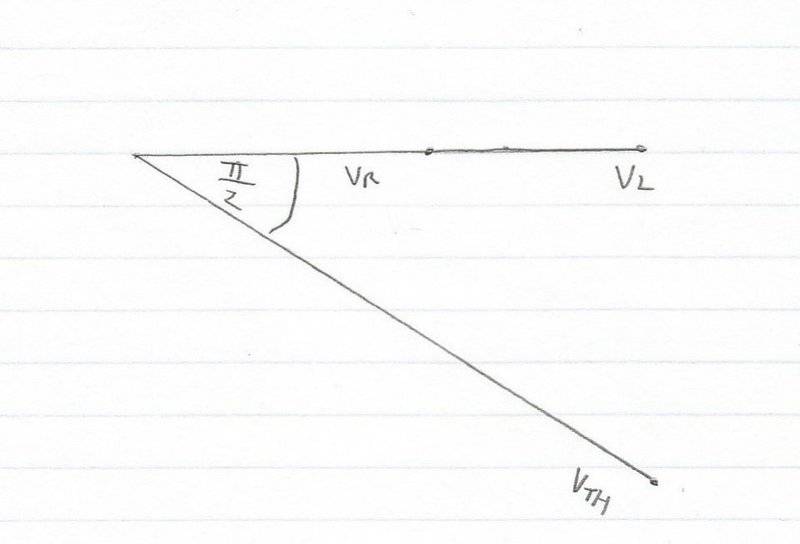

Would the phasor diagram look like this then?
Conor_B said:
I was taking VR to be the voltage drop for both the reactance and resistance.
Ok. Let's call it the Thevenin impedance drop Vz.
cnh1995 said:
Edit: Just to confirm, are we using the same terminology? I am taking VR as the voltage across the thevenin resistance, VL as the voltage across the storage heater load and Vth is the mains voltage.
In your diagram, you have shown Vz leading Vth by 45°, which is not true. Phase difference between Vz and Vth is not 45°. You need to show the Thevenin reactance drop Vx too in the diagram (drop across the line reactance).
Start with the horizontal load voltage phasor VL. How will Thevenin resistance drop VR and Thevenin reactance drop Vx be added to VL? You know the magnitudes of these three and their phase relationship. You also know that their phasor addition will give you Vth. Could you proceed with this?
Start with the horizontal load voltage phasor VL. How will Thevenin resistance drop VR and Thevenin reactance drop Vx be added to VL? You know the magnitudes of these three and their phase relationship. You also know that their phasor addotion will give you Vth. Could you proceed with this?

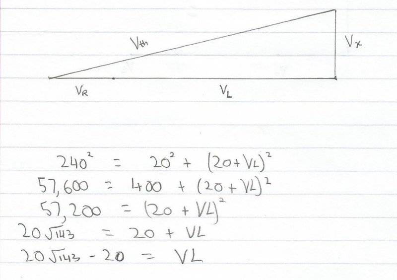

I'm not sure. Do I take the VL and the 20(Vr) both to be on the horizontal axis and just put j20(Vx on the Vertical axis?
Where do I draw Vth?
Exactly. The reactance drop j20 will be vertical, on the tip of the horizontal phasor (VL+20). It is in quadrature with the resistive drop.
Vth is the "phasor addition" of voltages on horizontal and vertical axes. Don't they form a right angled triangle? Vth is its hypotenuse. You know the magnitude of the hypotenuse and the vertical side. You can compute the length of the horizontal side and get the load voltage.
So, is this it?
Conor_B said:
So, is this it?
Your calculations are all correct, but in your phasor diagram, you should swap Vr and VL since you have assumed VL as the reference phasor. It's a standard practice to draw the reference phasor first and then draw the remaining ones.
