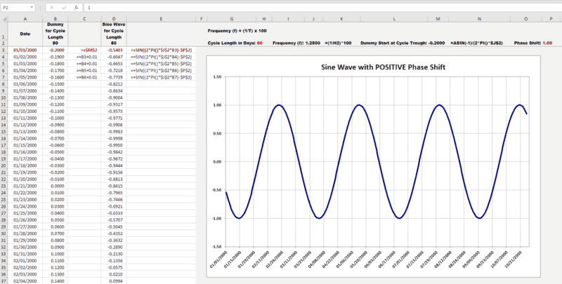

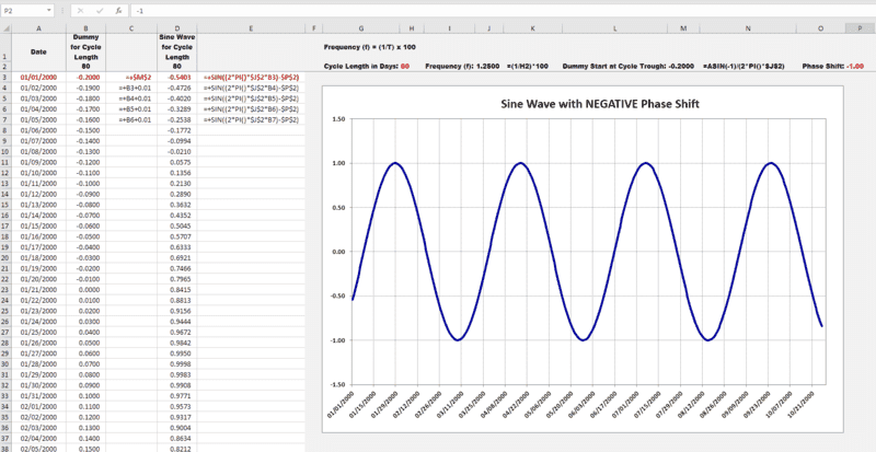

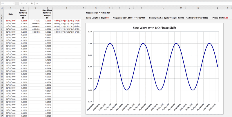

Hi berkeman,
I have attached three screenshots:
1.) - with NO phase shift (in cell P2 the value 0.00 is entered)
2.) - with POSITIVE phase shift (in cell P2 the value 1.00 is entered)
3.) - with NEGATIVE phase shift (in cell P2 the value -1.00 is entered)
All screenshots uses 80 days for a full cycle of the sine wave. BUT the cycle length changes, it is NOT always 80 days it could be also 125 days, 95 days, 168 days, and so forth.
I hope this helps.

steven757 said:
3.) - calculating the phase shift, so that the sine wave moves a specific amount of time/days forward when I enter a positive value greater "0" in the "Phase Shift" input cell ("N2") or backward when I enter a negative value smaller "0" in the "Phase Shift" input cell ("N2").
Here is my Excel formula:
=+SIN((2*PI()*$H$2*B4)-$N$2)
You want a different form of the sine wave, sin(k(d - d0))
A positive value of d0 will shift the sine wave left by d0 days, a negative value will shift it right.
I'm not sure which of those cell references corresponds to the day number d. But basically you want the shift to be grouped with the day, (d - d0).
