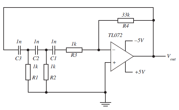

Phase shift oscillator and circuit
In summary, the conversation is about the simulation of a circuit involving a TL072 op-amp. The circuit is a phase shift oscillator and the goal is to determine the frequency of oscillation using PSpice simulation. The conversation includes discussions about the impact of the op-amp's phase shift on the frequency and how to find an ideal op-amp in PSpice. The circuit is found to have a frequency of 55 kHz, but the time steps and resolution of the simulation need to be adjusted for better results. The conversation also suggests using an initial voltage for one of the capacitors and implementing a smooth amplitude limiting device for better waveform results.

'Frequency of oscillation was observed to be about 15 % lower'[/B]
Why ?

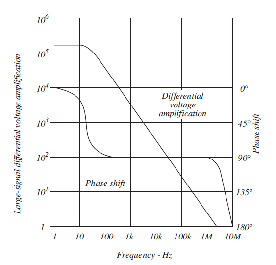

so at this frequency the op-amp has 45 phase shift, but why will this impact the oscillator and lower the frequency.

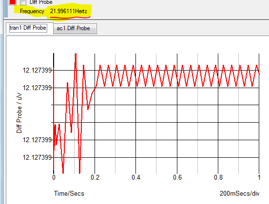

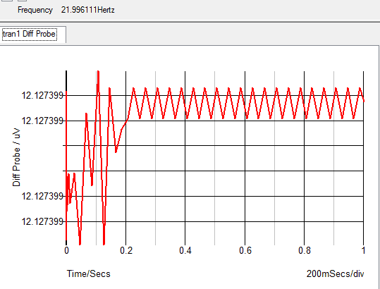

why is my frequency 22 Hz

65 kHz is my worked out frequency but PSpice is 22 Hz

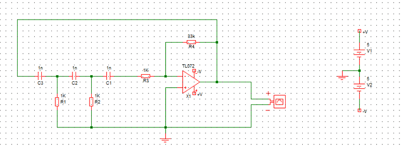

I have simulated your circuit - and the result is at 55 kHz.
What are the time steps you have chosen?
My choice: End of simulation 1ms and resolution 1µs.
Why such a large simulation time for 55 kHz(1s)?
Comment: A much better waveform can be achieved if you split the feedback resistor in two (33k=23k +10k) and connect two diodes (antiparallel) across the 10k resistor.

i think something is wrong with this iam still getting 22 Hz
i have to write a report about why the circuit is 15% lower from designed frequency, when the TL072 op-amp was used.

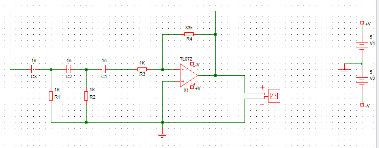

did you use PSpice to simulated the circuit? can you see any differences between your circuit and my one ?
could you email me your simulated circuit ?
I have simulated exactly your circuit using a realistic model for TL072.

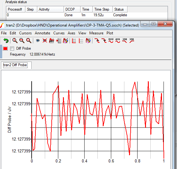

i have chanced the run time to 1m the freq is now 21 kHz

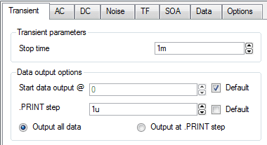

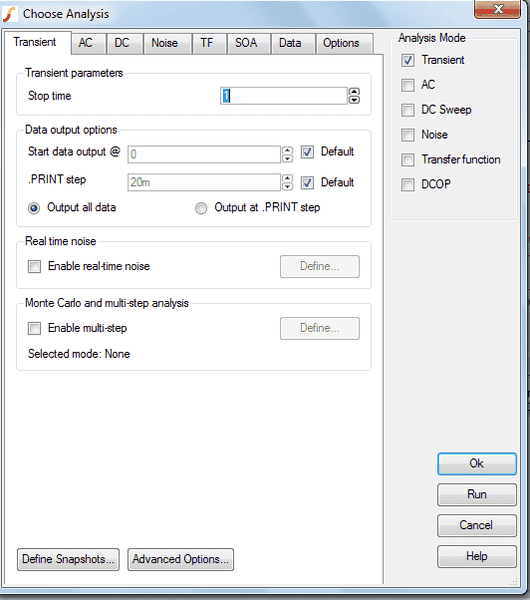

but where can i change time resolution ?

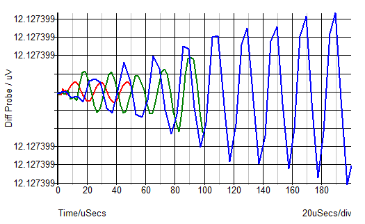

why when the stop time is change dose it effect the frequency.
red is 50 u
green is 100u
blue is 200u

I can't help because I don't use (or know about) Pspice (For a simple cct like this, I'd just build it!)
But going back to your first post, why do you say that the phase shift of the op amp is 45o at 55kHz? AFAI can see, it would still be close to 90o. It would appear to be 45o around 12Hz (and maybe 50MHz.) (Both taken from your graph - not checked by me.)
Looking at your Pspice output from an innocent perspective I wonder;
why your output amplitude is so small?
whether you would be able to see 50-60kHz oscillations?
what the waveform you are seeing really is?
what sort of mathematical accuracy Pspice is capable of? Does it give "digital noise" like rounding errors?

In my post#7 I gave you my simulation data (PSpice) with the result of app. 55kHz (clean sinewave).
I cannot understand why you didn`t try the same end time (1ms) and resolutiuon (1µs).
Are you aware that for an end time of 1s you expect to see on the screen 55000 oscillations? Does this make sense?
More than that, you should know that the simulator automatically selects a resolution (a certain percentage of the end time) which in many cases (as in yours) is bad because you had specified an end time which is much too large (1s).
That is the reason you see no sine wave - and the frequency is incorrect (too small).
Therefore you must override this automatic and specify a maximum time step as I did for my simulation.(1µs).
It should be possible for you to find out how you can command such an upper limit for the time step.
Furthermore, for a quick and save start of oscillations it is to be recommended to give one of the capacitors an "initial voltage".
Otherwise it takes a long time to see oscillations (if any).
EDIT: Which simulator are you using? Try ".print step" or "advanced options" for specifying the maximum time step.
resolutiuon= .PRINT step ?

ok with the initial voltage on the capacitors this is much better :)
thank you LvW
sorry iam a bit slow
OK - I hope you have learned now how to simulater an oscillator:
* Use a simulation time of app. 20-50 periods (maximum)
* Use a resolution (time step) of app 1/1000 of the max. simulation time
* Provide a starting aid by using an initial voltage for a capacitor.
* For a better waveform (low distortions, lowTHD) use a smooth amplitude limiting device (diodes, for example).
