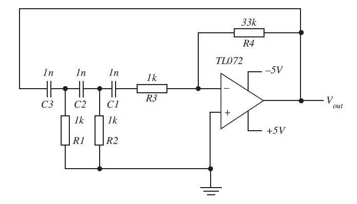

1. The problem
FIGURE 4(a) shows the circuit of an oscillator and FIGURE 4(b) gives
the gain and phase response of the op-amp used.
When the circuit was simulated in PSpice using an ideal op-amp, the
circuit oscillated at the designed frequency. However when the ideal opamp
was replaced by the TL072 the frequency of oscillation was observed
to be about 15% lower.
Investigate this anomaly giving your answer in the form of a report of
about 750 words. The report should attempt an analysis of the circuit
and include the results of any PSpice simulations. You may wish to use
the transfer function derived as equation (6) in the appendix to lesson
3-1 to calculate the phase shift in the RC network.

so this is what i have written so far, but i don't actual now the reason why.
I'm thinking it is to do with the input impedance of the TL072 causing load on the RC network?The figure show is a phase shift oscillator. the frequency determining network (FDN) RC network in the feedback loop is designed to produce 180° phase shift at the desired frequency. Each RC element of FDN will give 60° phase shift so that the three sections together give the required 180°. The 180° phase shift occurs between the input to a RC network and the output from the network. The inverting op amp with its 180°phase dang completes the unity loop gain at 360°. The phase shift occurs only for the selected frequency to which the FDN is tuned.

Where are the circuits?
Don`t forget the (parasitic) phase shift contributed by the opamp.

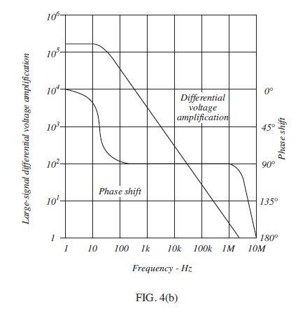

for your help I have included some screen grabs with more info.
The ideal op-amp will have;
  • infinite gain
  • Infinite input impedance
  • no output impedance.
The oscillation frequency of your circuit is designed for app. 60 kHz.
From the frequency characteristics of the used opamp you can derive if (and how much) the parasitic phase shift of the closed-loop gain amplifier will influence the frequency of oscillation. That is the most important influence of the real opamp. In addition, you should analyse the slewing properties of the opamp used.

Because of capacitor between the output and the negative input.
The circuit will oscillate at a frequency where the loop gain phase is -360deg.
The inverting input will contribute -180deg and the non-ideal opamp will contribute another -X deg.
Hence, the oscillator will have a frequency where the passive feedback network contributes -(180-X)deg.
This will be a lower value than designed.
It is your main task to find the value of X.

The OP-AMP graphs show a voltage gain much lower than you might have hoped, and a phase shift markedly different from what you probably expected, in this circuit's region of operation.
Additional hints: The opamps open-loop gain and phase function shows a remarkable phase shift at app. 60 kHz.
From this you can derive an estimate for the closed-loop (unwanted, but unavoidable) additional phase shift X.
This gives some information on the actual oscillation frequency.
I calculate the frequency of operation to be 65 kHz.
from the graph we can see the phase shirt is 90 deg.

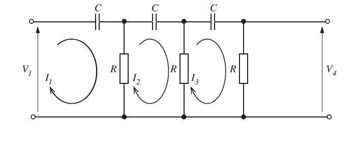

The question also says
"You may wish to use the transfer function derived as equation (6)"
the info given is
(where ωo is the angular frequency at which the transfer function of the RC ladder is purely resistive) see attached.

Don`t forget: The 90deg phase shift is for the open-loop gain.
But your opamp is eqipped with feedback leading to a much lower closed-loop gain (which, of course, effects the phase).

rude man said:
This won't be of any use if the transfer function is V4/V1 since this network feeds into a virtual ground.
The equation is appropriate (providing we can regard the input as a virtual ground), because the phase-shifter's R has been repositioned so OP-AMP input current is proportional to V4.
There is no virtual ground. The gain of the op amp at 60 KHz is far below infinity! The V4/V1 transfer function is useless, R "repositioning" or not.

The gain is even lower than your expression k/s, k = 100(2π)(60 KHz) gives.
If you look at the TL072 gain and phase parameter plot posted earlier, and reproduced here for reference:
the gain curve crosses a gain of 100 just a little less than halfway between 10k and 100k. Considering that the frequency axis is logarithmic, the frequency at which the gain is 100 is nearer 30 kHz than 60 kHz, so the gain is more like 50; worse yet.
The OP didn't post any information about the output impedance of the opamp, but the data sheet: http://www.ti.com/lit/ds/symlink/tl072.pdf
figure 6 allows us to infer that a reasonable value would be 200 ohms.
