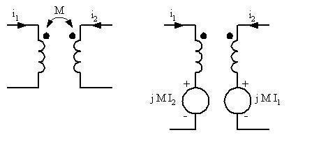

gneill said:
Maybe check that the signs of the mutual inductance terms respect the dot notation and choice of loop current directions?
I don't entirely understand how to deal with the polarity marks, but I've tried switching plus and minus for the j24Ω term. It's my understanding that they should both be -j24Ω, multiplied by I1 or I2 respectively, but I've tried both minus, both plus, one minus, one plus, the other way around, and none of the answers are correct.
I've taken a closer look at your circuit and I believe that you have them correctly oriented. Sorry for the bother.
The idea is that a positively increasing current flowing into one coil at its dot produces a positive polarity of induced voltage at the dot of the second coil. So you have to be attentive as to whether a positive increase in the mesh current will create a positive increase in the current flowing into the coil dot, or whether it will in fact cause a decrease.
