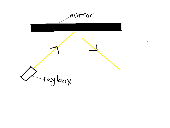

I wonder why is there a gap at the starting of the reflected light when i conduct this experiment? Can anybody explain this to me? Thanks!
Welcome to Physics Forums.
Can you describe your experiment a little more? Specifically, exactly how are you "observing" the light ray or beam?
If I had to bet, I would guess that you are using a card or sheet of paper to see where the light beam is. When you hold the sheet near the reflecting surface, it is actually blocking the incident beam, making it appear that there is no reflected beam right near the surface. But in reality there is no reflected beam because the incident beam is blocked before it reaches the surface.

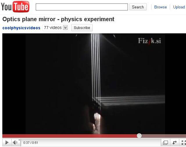

The experiment that I conducted is similar to this>>http://www.youtube.com/watch?v=LMmnuUOZ6ho&feature=related
From the video,it is obvious that there's a gap between the plane mirror and starting of reflected ray. Why does this happen? Is it caused by the glass and the coating of reflective metal in the mirror? But how?

Redbelly,How do I pause the video?I need to look at it more carefully but it seems to be a front coated mirror.On second thoughts......
I think I see it.Firstly there is obviously a fairly strong reflection but the incident rays seem to travel on a short distance before stopping.This is due to those rays which are passing over the top surface of the mirror and being scattered(in the same way that the rays are made visible by scattering on the white paper).In a lot of views those rays are not visible beyond the back surface of the mirror because the mirror itself has blocked/reflected those rays which are grazing the surface.Those "higher"rays do pass beyond the mirror,however,as evidenced by those views where the experimenters hands lie in the path of the incident rays.Take another look at the video and you will clearly see the rays passing over the experimenters fingers.I think the apparent lateral displacement is due to reasons outlined in post 6.

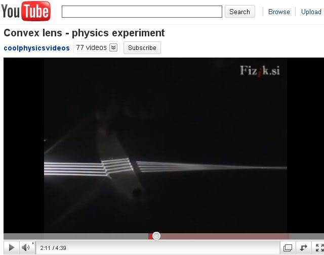

There is a similar effect in this demo of a lens by the same person. I suggest pausing the video at about 2:11:
In this video, we don't have to wonder about front surface vs. back surface mirrors. The ray paths are pretty unambiguous.
FWIW, I have taken video snapshots. I think it's pretty clear that the gap is not caused by having a back-surface reflector:
And from the convex lens demo by the same person (people?):
I looked through some additional pictures and noticed the same thing occur in a good number of them (coming from both a reflection and a refraction). Could it be from a phase change by reflection (though, I'm not sure how well this would apply to the refractive case)?

Snapshot two is using a base coated cylindrical lens which shows the refracted rays inside the lens and because of refraction these rays to be closer to the surface than they actually are(real and apparent depth phenomenom).This results in a real gap but it is vertical(along the lines of the normals to the top and bottom surfaces)rather than horizontal.The size of the gap seen depends on the viewing angle and for a perfect plan view no gaps will be visible the incident ,refracted and emergent rays all terminating at the edges of the lens.The video from which the snapshot is taken shows clearly that there is no visible gap for front surface reflection(see,for example 28 to 31 seconds)
