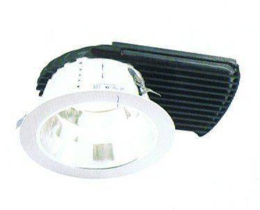

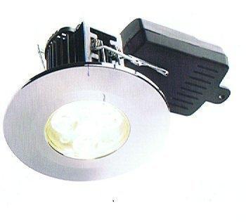

Here are some commercially available high power LED lumieres that address the cooling issue.
Note the cooling ribs on the fitting.
These also have full IP65 / fire ratings
This is not the place for advertising so I can't post more details but the catalogue has all the design information needed.
I'm okay with you posting links to this info, Studiot. I'm interested in learning more as well.
