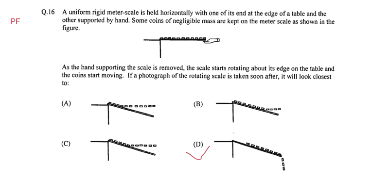

The option (a) says that the 1st coin remains at its earlier position. Due to gravitational force, the 1st coin falls down, hence option (a) is wrong.
I don’t understand the difference between option (B) and (C).
In my opinion, both option says that all of the coins which have left the scale falls down having same position vector.
I am not being able to apply Newton's laws of motion here.

The forces acting on the coin after leaving the scale is m ## \vec g ## .
The torque on the scale about the fixed end is
## mg \frac 1 2 L = \frac { mL^2} 3 \alpha ##
## \alpha = \frac { 3g } {2L} ##
that part of the scale ( which is at a distance L' > ## \frac { 2L} 3 ## from the pivot ) has an acceleration magnitude ## \geq g ## .
So, the coins at a distance L' > ## \frac { 2L} 3 ## will leave the scale, while the rest of the coin will remain on the scale. Hence, the answer is option (B).
Is this correct?
As I read diagrams a to c, they all show the leftmost coins still on the scale, with the rightmost forming a horizontalline below the initial position. They only differ in where the bend in the line is. Yes, diagram a) has the bend very near the left, but not quite.
So you need to solve the problem analytically to find whereabouts the bend shpuld be, then see which diagram looks closest.

Why not? Try to determine the initial angular acceleration of the scale.
Is this correct?
Looks good.
