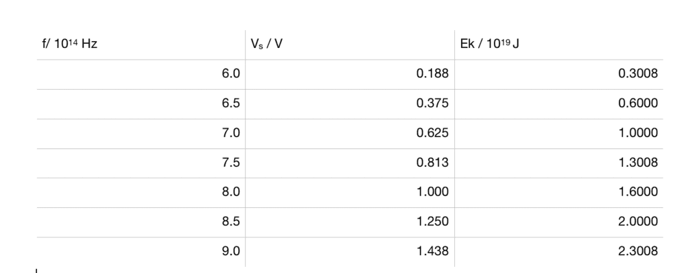

Different stopping potentials were measured for different frequencies of electromagnetic radiation.
1. a. Plot the results from table 1 in a graph with maximum kinetic energy EK on the y-axis and frequency f on the x-axis.

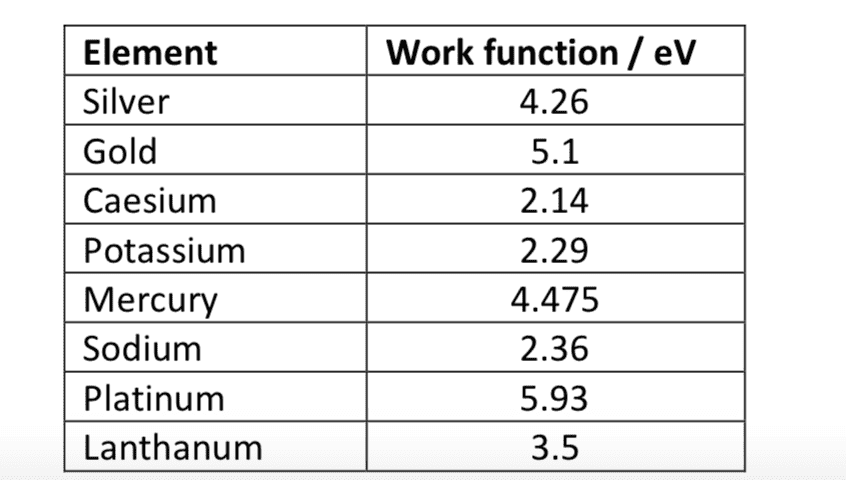

c. Using Table 2 and your answer to b ii, find the metal that is being tested.

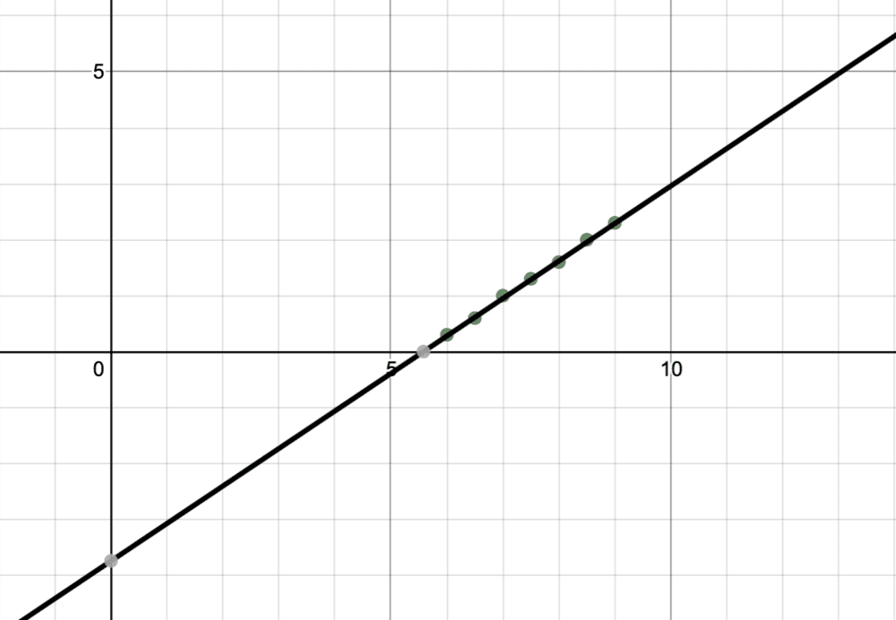

1. a)I have plotted the graph on desmos and attached an image here.
b i. The threshold frequency is equal to the x-intercept ~ 5.6*10^14 Hz
ii. The work function is equal to the y-intercept ~ -3.75*10^19 J (would it be correct to state that this value is negative?)
c. Convert to eV;
3.75*10^19 J=2.34375 eV
Evaluating table 2 I believe that this approximately corresponds to the work function of sodium, 2.36 eV. Such differences in values may have arisen from graphical uncertainties on my part.

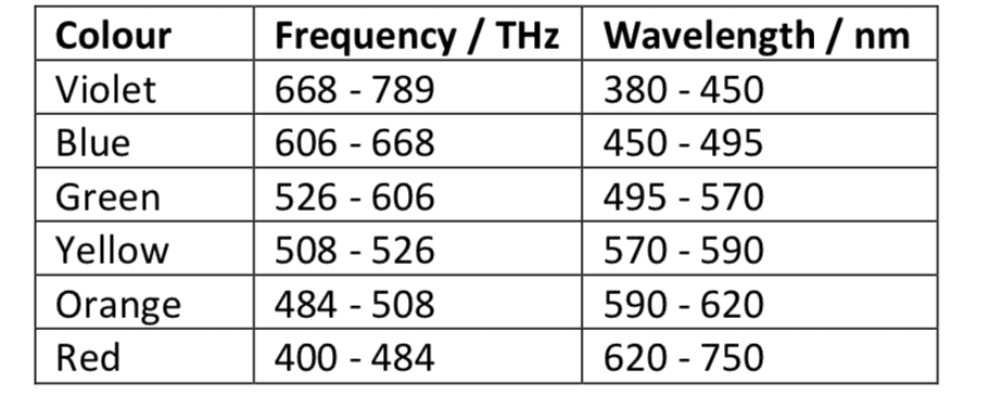

Evaluating table 3 a blue photon has a frequency in range 606-668 THz. Converting to Hz this 6.06*10^14 Hz-6.68*10^14 Hz

e. If a beam of yellow light was shone on the metal the energy of the photon can be found by (frequency range of a yellow photon is 5.08*10^14 Hz-5.26*10^14
E=hf=6.63*10^-34*5.08*10^14=3.368*10^19
E=6.63*10^-34*5.26*10^14=3.487*10^19
Convert to eV; Energy in range= 2.10-2.12 eV
The work function of the sodium has been shown to be 2.36 in table 2. Since this energy is less than the work function, meaning the yellow photon does not have sufficient energy to eject an electron from the sodium metal.

(a) Not OK, what did you plot? There are no labels to the axes.
(b) If you use the equation 1/2 m v^2 max = hf-Φ, it would not be correct to substitute a negative number for Φ. Do you see why?

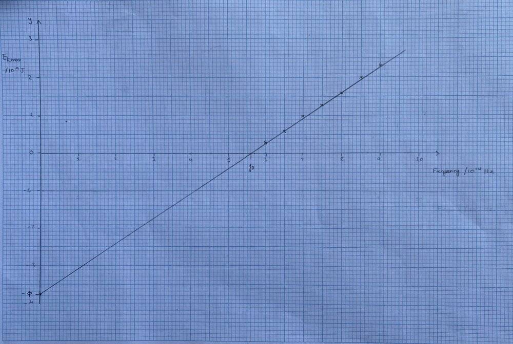

a) I just plotted this quickly on desmos. I will attach my hand-drawn graph which features fully labelled axis.

The value of the work function in eV = 2.36 eV

No, the vertical axis is not kinetic energy unless you measured the speed of each electron, a daunting task to say the least. What did you measure and how is that related to the kinetic energy of the electrons?
No question 1. a. states " Plot the results from table 1 in a graph with maximum kinetic energy EK on the y-axis and frequency f on the x-axis"
And exactly how did you measure this maximum kinetic energy? Did you read an instrument that had a display labeled "kinetic energy"?
No, I did not measure the kinetic energy, I calculated it using 1/2 mv^2=e*Vs. I understand this question is referring to the photoelectric cell experiment but it does specify to plot maximum kinetic energy on the y-axis, not the stopping voltage.
Sorry I an confused should I not have plotted maximum kinetic energy on the y-axis?

For d) Finding the energy of the incident blue photon in the range of the given frequency;
1/2 m v^2 max =4.1357*10^-15 eV* 6.06*10^14-2.36 eV
1/2 m v^2 max =0.1462342 ~ 1.46 * 10 ^-1 eV
1/2 m v^2 max =4.1357*10^-15eV* 6.68*10^14-2.36 eV
1/2 m v^2 max = 0.4026476 ~ 4.03*10^-1 eV
Is this correct (Planck's constant and the work function are in eV and the frequency in Hz) so the maximum kinetic energy a phototelectron emitted from an incident blue photon would have would be between 1.46 * 10 ^-1 eV-4.03*10^-1 eV
Your range of kinetic energies for blue light looks about right.

You absolutely need to fix your plot. The labels and numbers are not the only issue with it. If you label the vertical axis as "kinetic energy", you need to explain what the negative "kinetic energy" at the y-intercept means and why.

Moreover, I have attached my hand-drawn plot, would this be better? I know that the work function is negative at the y-intercept but would this be ok since comparing the photoelectric effect equation with the equation of a straight line;
Ek=hf-Φ
y=mx+c
Therefore, by subtracting the work function in the photoelectric effect equation, its negative value will cancel to a positive?

AN630078 said:
I know that the work function is negative at the y-intercept ...
The work function is never negative, so don't say that. I know what you mean to say and this is how you say it. When one compares the equations Ek=hf-Φ and y=mx+c, one sees that the y-intercept c in a plot of Ek vs. f is the negative of the work function Φ. In this case c = - 2.36 eV, therefore Φ = +2.36 eV. And yes, this new plot is better.
Likes AN630078
Thank you very much for your reply and for offering a preferable statement 👍
