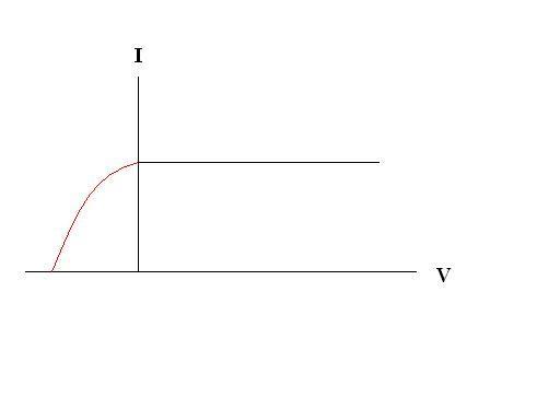

In summary, the photoelectric effect shows a saturated current starting at the y-axis (0,y), with a gradient at the negative x-axis (shown as a red line). The relevant equations are hf = 1/2 mv^2 + e(Vs), and the reason for this behavior is that the rate of emitting or collecting electrons is increasing from zero to that value. However, this is only a description of what is observed, not an explanation for why it occurs.

In photoelectric effect, why the saturated current starts at the y-axis (0,y)? and what is the reason for that gradient at the negative x-axis (Shown as a red line)?

Knightycloud said:
2. Homework Equations
3. The Attempt at a Solution
Because the rate of emitting electrons is increasing from zero to that value.
Am I right?
Am I right?
Well, it's more the rate of collecting electrons I'd say, but that's only a description of what's observed and what the graph says, not an explanation of why it's like that.
