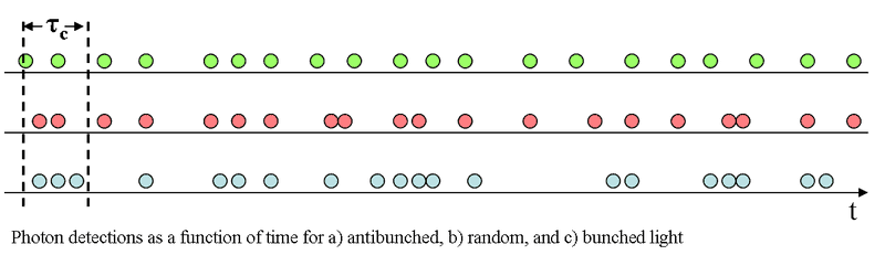

The green dots represent photons in an anti-bunched state, squeezed light.
The red dots represent photons in a semi-bunched state, laser light
The blue dots represent photons in a bunched state, thermal light
The complex setups used in entanglement experiments only squeeze light in amplitude, phase, photon number and filter out squeezed light from classical light before the beam splitter can perform entanglement.
But if you are lucky, you just need two sources of squeezed light, which are usually non-linear crystals but single-photon sources will do too. Maybe in the future they will discover more ways to produce anti-bunched photons.
You also need the photons from the two input beams to be indistinguishable in polarization, frequency, arrival time. Unless you want to use an artificial device that removes these properties composed of two special detectors (not any detector!) that can erase which-path information and a phase shifter.

https://en.wikipedia.org/wiki/Photon_antibunching
Photons are more equally spaced (more delayed in their arrival time) in squeezed light than in a laser beam, and more equally spaced in laser beam than in thermal radiation
It's about the Bose-Einstein statistics, which makes photons bunch together in pairs. These bunched pairs are filtered by nonlinear crystals
Photons are more equally spaced in squeezed light than in a laser beam, and more equally spaced in laser beam than in thermal radiation
Be very, very careful when creating mental pictures like that. You can't strictly speaking talk about individual photons unless you have a Fock state. There is nothing preventing you from talking about average number of photons, but you can't really talk about "spacing" between photons in this case.
Likes bhobba
It's not me but Wikipedia. Plus photon spacing means delay between their arrival times, not distance measured in meters
Wikipedia is not always correct.
